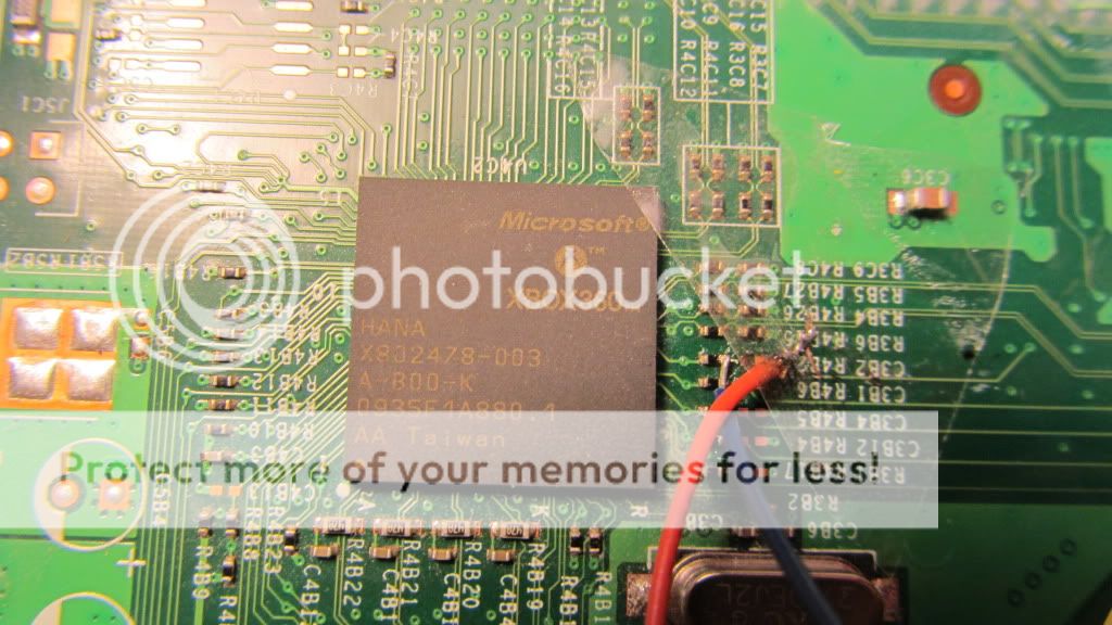

i finished soldering and by mistake i pulled the cable and lifted the trace till the red dot i made in the picture
is there something i can do ? can be fixed ?

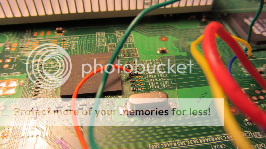

i'm glad , now i'm here thinking , can i use one of the cables that come with the jrunner for the slim to do that, which would be best green, blue or yellow ?
i will do this point as i don't want to scrap if is not a must

ps. when i pulled the cable the trace lifted but remained soldered to the cable, it didn't burn nor tear up, so no need to do anything to it right ?
lifted trace :
Unfortunately, this is where misunderstanding a repair is what causes problems.
Regardless of what point you want to solder to for STBY_CLK, you MUST repair the damage you've already done or your console won't power on.
If you feel you can't do it, get someone who can. Right now it's an easy fix.
EDIT - you still need to repair the trace. Look at the close up images in the linked post.

now i'm on trying to repair the trace but i'm not sure about something.
to scrap the trace i should scrap in the area next to the trace or over the trace ?

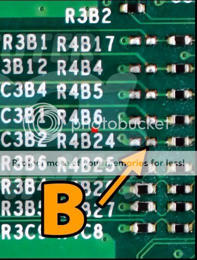

if you still have a wire soldered to the trace (which is currently unattached at one side), solder a wire from the resistor next to the solder point you used (the side which should be joined to your trace) and the other end to the B pad on your coolrunner. There's plenty of room on the pad for two wires. If this works, tape down the end of the trace which is currently loose (or hot glue it). You're then done.
i think i'm done . how do i test if it works ?
thanks for the help

it powers but got red ring of dead. (3 red light )
so i guess i did it wrong , right ?
johannlynx
Nov 30, 2011
56
lol it was cuz i didn't plug it to the tv :facepalm:
i plugged to the tv to check the code and it works :)

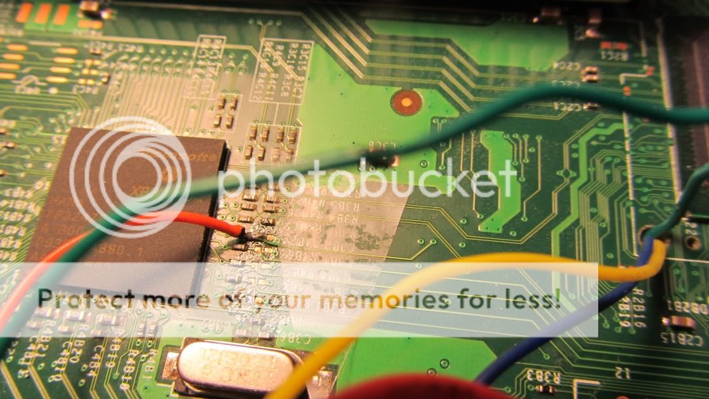

i used a little of ductape then i tested again if the xbox was booting and everything was fine. :)
thanks for all the help

Looks a bit messy...if you can try and clean it up to prevent more problems. If you're happy with the tape on it then that's fine.
