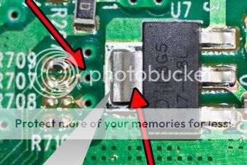

ok so you will be attempting to flash the liteon 74850. all you need to do is probe the r707 hole on the drive and follow the tutorial. i assume the ribbon you are referring to is the laser ribbon? its recommended to remove this as its widely thought that leaving this connected whilst flashing the liteon can lead to the open tray error. if im mistaken then let me know and ill help you out some more.

am sorry it is a liteon 74850c so it is ok to take the ribbon off frist and then follow the tutorial yes laser ribbon is what i am talking a bout thabks

like to say thanks flash my frist one on trobble at all ok so you will be attempting to flash the liteon 74850c. all you need to do is probe the r707 hole on the drive and follow the tutorial. i assume the ribbon you are referring to is the laser ribbon? its recommended to remove this as its widely thought that leaving this connected whilst flashing the liteon can lead to the open tray error. if im mistaken then let me know and ill help you out some more.
