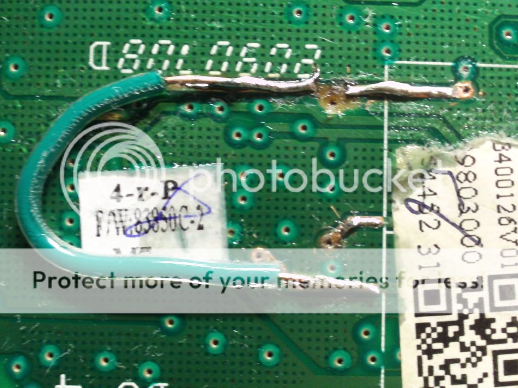

i just checked out your site... and holy crap youve got some skills to fix that :Shes lifted 1 pad which takes 10 seconds to sort. check mine or tj's site to see messes.

Pad 101 fell off... It's still possible to fix the cuts?If you attempted MRA, be sure to fix the traces before using the Probe 3. JungleFlasher needs to be able to identify a drive before you can use PhatKey.

Hey I soldered it and it still doesn't show up in JF. Also, when I touch pad 101 with green prong and pad 122 with red prong on MRA, the CK3 lite and CK3 Probe 2 turn off.Thats an easy fix you just need to get a fibreglass pen and use flux.
It's not bad but its not great. Better than people I knowthat soldering is bad, anyway you need to bridge the trace cut below the missing pad 101.
How is it? And just saying though I kinda learned to solder by error. So overtime I have gotten better but how is it bad so I can improve?mate that is bad.
