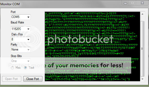

hey guys i think ill need some help again, i use the cable correct and proper soldered and when console glitches etc i see on monitor com the xell info with no proper letters
is it the font or anything?
Link To Image
Corona? I had the exact same problem. I left it on for a couple of hours and came back to scan the IP and the key popped in. You might try the same.
I think Xell is trying to load but its getting hung up on something. Maybe trying to acquire an IP?

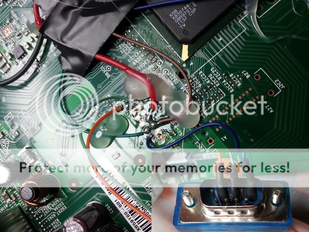

well everything seems to be put in place, im a bit tired today and i might be doing some stupid error, check it out too, i cant be that blind
heres the pinout too

I'm just asking what happens when you scan for an IP? It doesn't matter if the comm window is open or not.

I think the problem is that you need a ttl converter. The update cable is usb to rs232 ttl, or at least i thinkt it is, i updated my nand-x using a rs232 ttl cable from ftdi.
Google it, there are some easy solutions on DIY versions.
