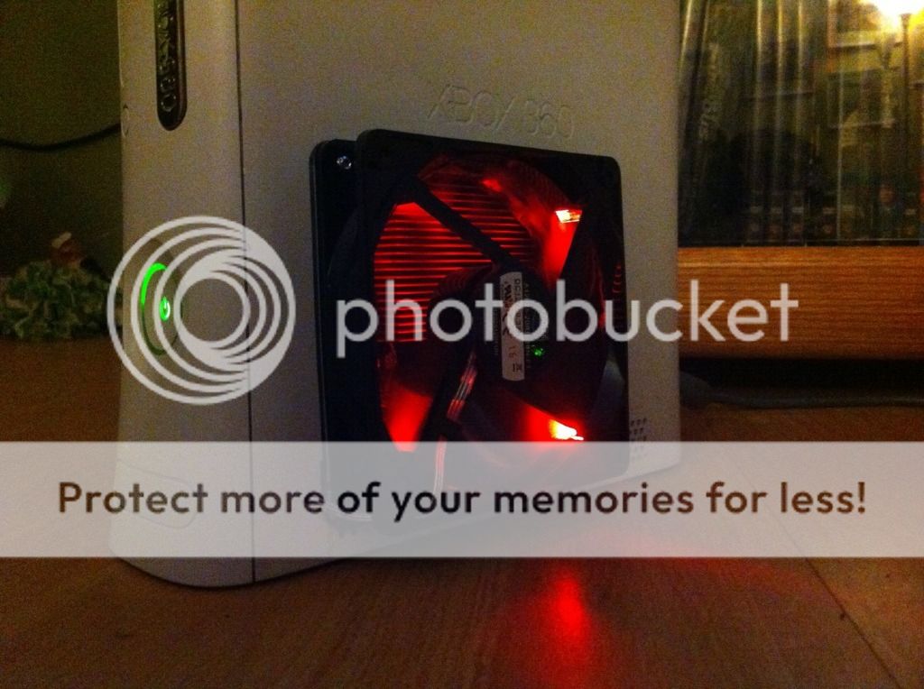

Hey guys so today, I took my old 360 out bought a new laser and rubber band. I installed it and decided hey i always wanted to put a fan directly over the heat sinks so i did, I had a 120mm cooler master red LED fan, and sodered it to the 12v source under the board below the power supply connector. then cut the hole and screwed it on. It now works like new and is my brothers now.
I have a 250gb Slim, I bought it new 2ish years ago and I now need to take it apart and do some dust clearing, while im in there i would like to know if there is anything i should do? and is there a way to help keep it cooler so it last for a long time.
