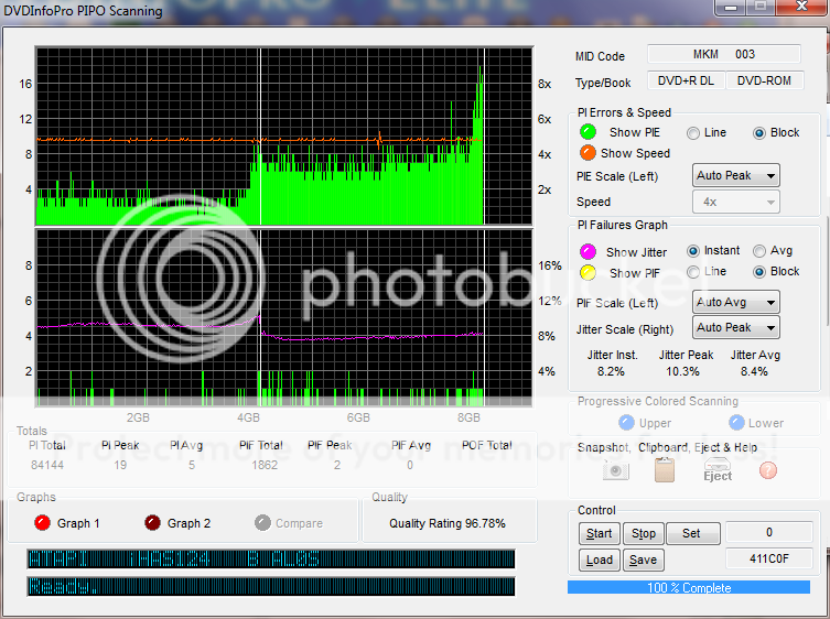

kprobe2
Nero discspeed
General Information
Drive: ATAPI iHAS424 B
Firmware: GL1A
Disc: DVD+R DL (n/a)
Selected speed: 8 X
PI Errors
Maximum: 104

kprobe2
Nero discspeed
General Information
Firmware: GL1A
Selected speed: 8 X
PI Errors
Maximum: 104
Average: 10.89
Total: 362937
PI failures
Maximum: 5
Average: 0.00
Total: 1169
PO failures: -
Jitter: -
Scanning Statistics
Elapsed time: 18:38
Number of samples: 249451
Average scanning interval: 1.07 ECC
Glitches removed: 0
errrr any suggestions
is this enough information
