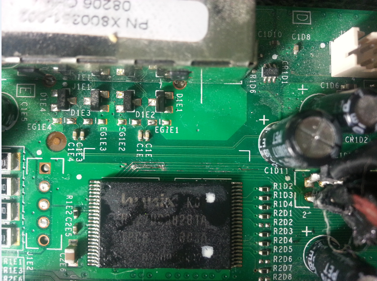

i found this xbox that doesn't turn on and i put my jr-pro v2 to read nand but then notice the trace on the nand where broken , is there a way to repair this other than joining those traces ( so damn small for me) or anyone here can attempt to fix it ? ill ship it to us.

That can be fixed with a skilled hand at soldering. If you decide to not fix it then let me know and I'll buy it. If your in the US that is.

i want to fix it just dont have the hand for it anymore , i can fix traces by themselves but so close like this cant really , if anyone do it cheap i dont mind paying for it
i tried with 3-gaw cables managed to get it to boot once but guess cables moved then again doesn't boot so removed them and cleaned the area

it looks to me like someone installed a dual nand that required cutting the ce trace and wiring it to a switch, in case you were wondering why it is like this.
