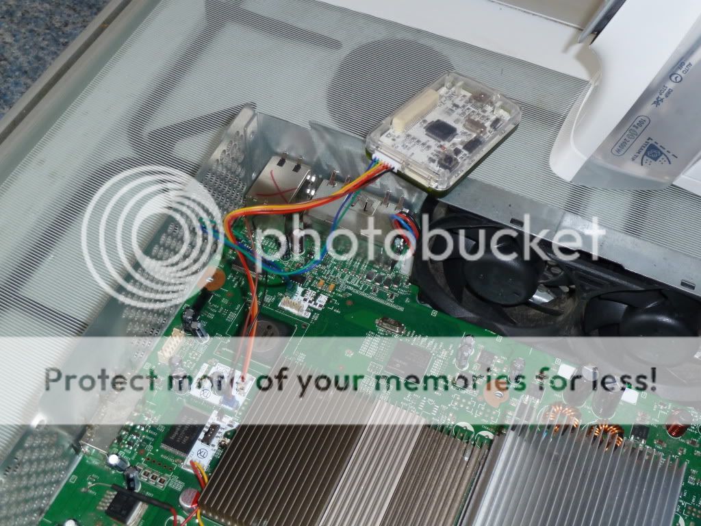

I have read through the forum extensively and have not been able to find a definitive answer to my problem, any advise / help would be greatly appreciated.
I have been fitting modchip for a good few years now, but have personally never been a fan of the QSbs
Anyway, a few days ago I decided to Jtagg an old spare 360 (confirmed as exploitable) using the nand-x and Jtagg kit
I successfully read the nand using nand pro 3 times, with 0 bad blocks and perfect matches

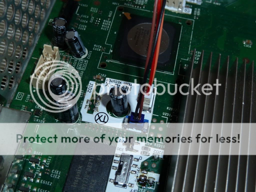

I then extracted the Key and config parts and injected them into the XBreboot for the falcon board, then used nandpro to re-flash the nand, again with 0 errors
Again it completed with 0 errors, however on turning the 360 on I was greeting with the E79 error, I then tried the over resistance values 33, 470 etc, but still the same E79 error.
At this point I decided it would be good to re-flash with the original Nand file, which I did and again no errors, turned 360 on and it now works perfectly again.
I then decided to re-read the nand using nandpro, but this time I got error 204 at block 0, and this was repeated 3 times so all 3 reads are the same.
Why and how would this be please?
I then decided to use Jtagg tool to write XELL to the nand, this also wrote with 0 errors, but still I get E79, does this point to a problem with my soldiering?
Once thing to is that I do not have hte DVD drive at this stage, would / will this casue an issue after the exploit? as the 360 boots fine with orginal nand image and no dvd drive.
Many thanks in advance, much appreciated
Sean

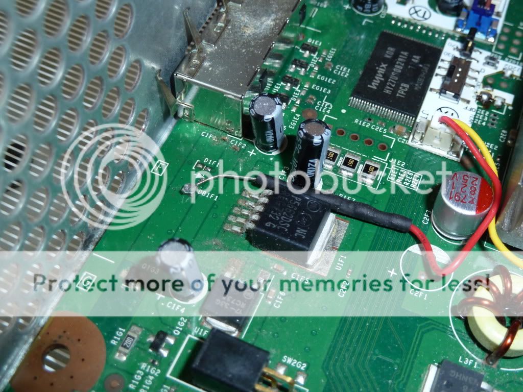

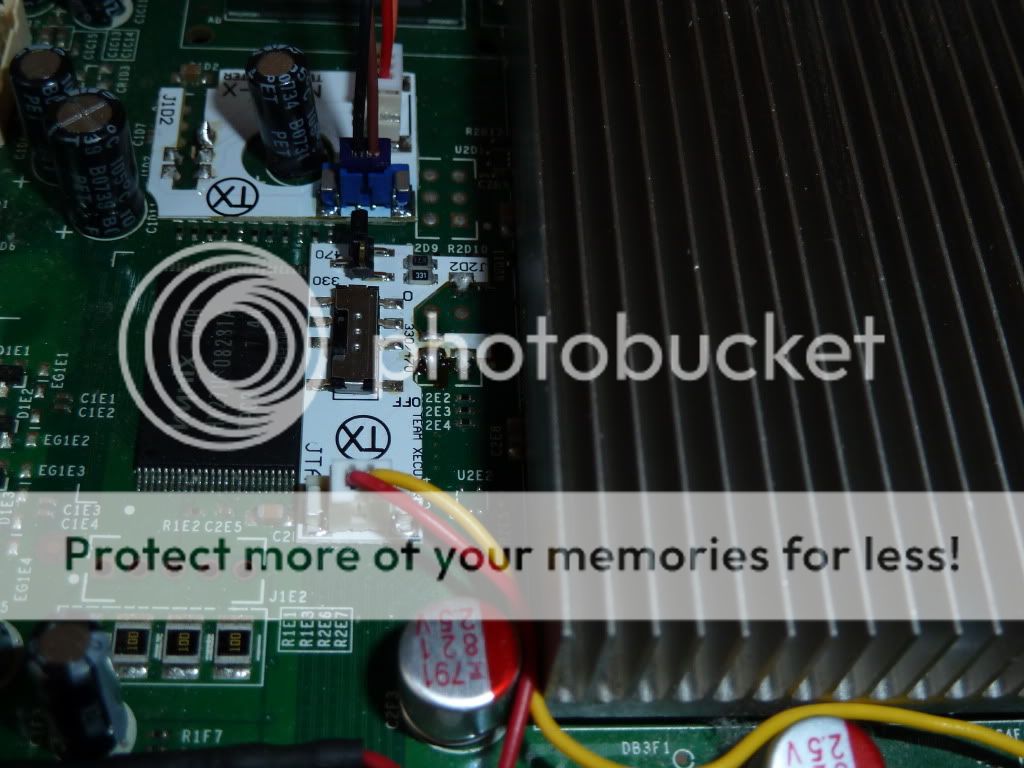

Xell will only boot via the eject button, however there is a mixed feedback about whether the DVD drive should be connected or not during xell boot. Give the alternate points a go in the link I posted to you. Remember you don't have to go through the whole XBR to freeboot process, you can just compile freeboot straight away using a modified SMC file.

Why remove the boards? Are you re-doing your work or going for the alternate points? If it's the later, just move the end of the red wire from DB1F1 and splice into the DVD open_tray signal wire and join them. As for the yellow one, you can just cut the wire and solder it from below the board at the same point and solder the diode end to the audio_clamp.
