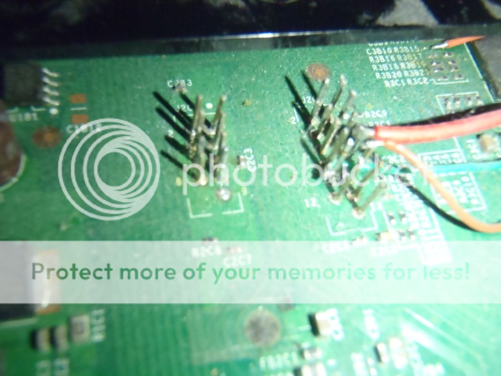

Ok so i have 3 rgh consoles 1fusion 1regular RGH 1RGloader well today i decided to flash the regular console back to stock to update it. So instead of using my nand x i used Flash360 so flash was successful updated to new dashboard now i go to read my nand an i get this
Version: 03
Flash Config: 0x00000000
Can not Continue
Can not continue
now i know its not a solider problem because i have pin headers installed an the last time i used the nand x was like 2 weeks ago but i accidentally turn the console on while the nandx was hooked up but it ended up working even after that but i go to use it today an boom
Version: 03
Can not Continue
Can not continue
could my nandx be fried...??:facepalm:

try martins nand x trouble shooting guide.. i had the same problem and it was southbridge related

Edit: read it an had the right voltage so i don't know maybe it is broke an i think if my smc was corrupted the console wouldn't boot cause it boots to the new dash an online fine.....:(
A damaged IC on the NAND-x may still write to the Coolrunner but will fail to read/write via SPI. This happens when soldering isn't good enough and points are bridged.
I can repair a NAND-x for £10 plus p&p. Alternatively, replace it with a J-R Programmer.

haven't tried that but it won't even detect the mother board from j runner program in the tools menu but i'll post a pic
thanks martin but i think i'll just replace it with a j-r program i've had the nand x for about 6 months now it's funny how these little things just go up after you just used the darn thing lol
