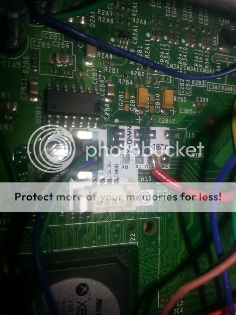

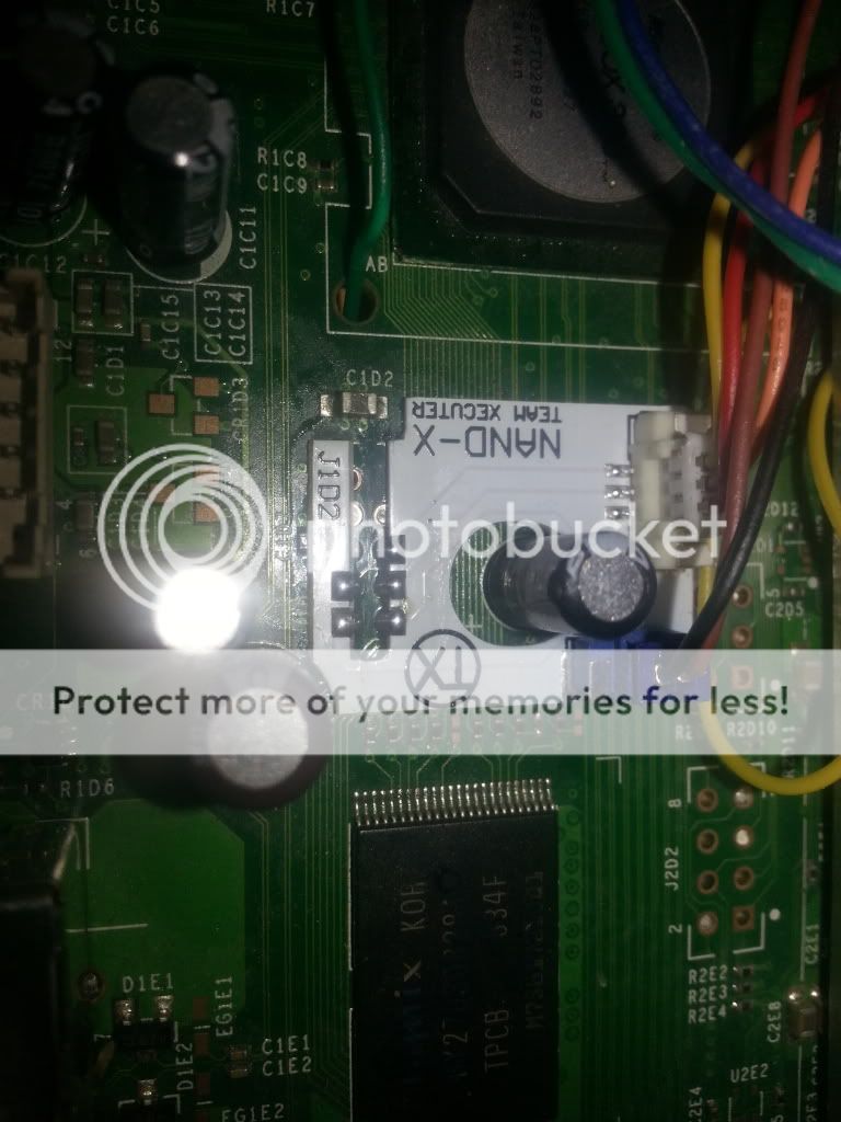

Hi all, Ive got a falcon,nand x , cr3 lite. I started by soldering the wires from the nand x to the mobo and never got matching dumps. Thinking it was my soldering i ordered the some qsb's but still get the same result. I get 2 bad blocks that jrunner relocates but they still dont match. When i check the differences its shows the first bad blocks add of 181. I have deleted this on 2 nands and they then compare. Now this is where i get stuck! The Create ecc option is greyed out in jrunner so i guess im still goofing it up still. Can anyone please point outwhat im doing so wrong? Thanks.
