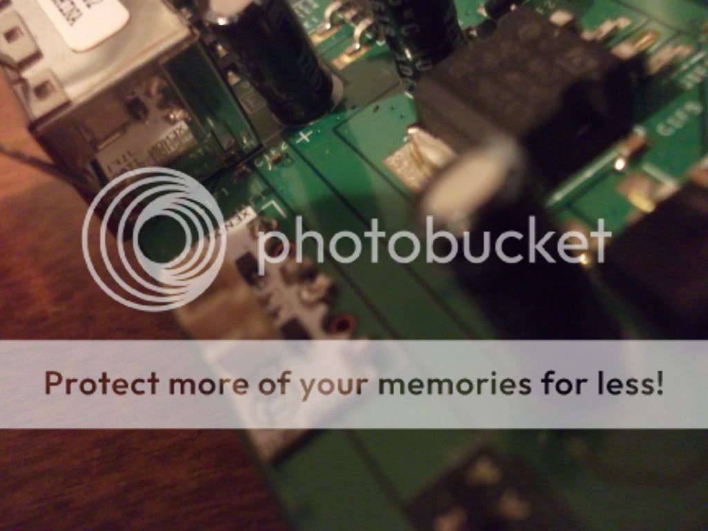

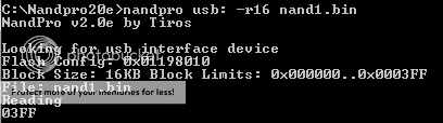

I apparently cant seem to get this right. Ithink I need a new soldering iron, but I can read and write to the nand fine and have exploitable kernel 6690 and CB version 1903. No matter what I do my Xenon refuses to give me anything but E79. I realize that the picture shows the jtag turned off it was not set this way when I was trying to boot xell.

Its probably your JTAG wiring. If you have a multimeter, you can check your joints. If not, try putting some flux on the points and resolder the connections.
Its a bit hard to see, but one or more of them might not be connected to the board properly. Helps if you focus, but still hard to see even then.

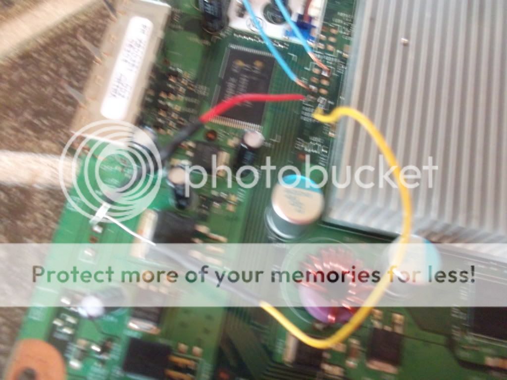

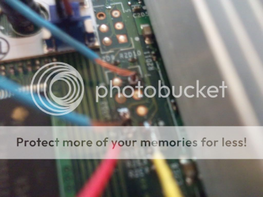

I tried that heres my current setup:
Since Ive been spending forever on this I was wondering if this would be an ok alternative.

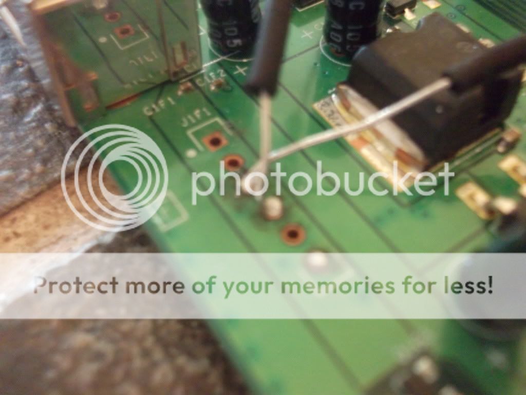

looks like your soldering needs re doing but wait till you have some flux ..
an i think your wires on j1f1 need 100% re doing and maybe cut the ends slightly
