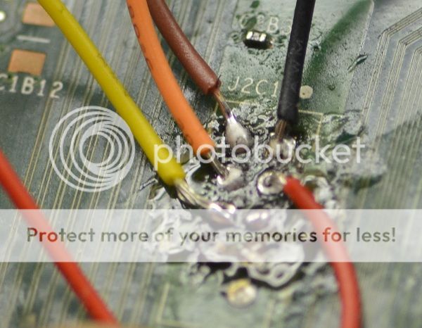

I cant seem to read any HDMI Motherboards - I have tried 3 slims and one falcon and it wont read any. Have re-soldered several times. All points checked with a multimeter. It will read a Xenon just fine.
Here are some images of last trinity I did. Not the best connections as I'm getting frustrated but like I said they were all tested and confirmed to be solid.
13,721
For starters, you should trim those wires down and clean up all that excess flux.
Does J-Runner detect your NAND-X when you connect it to the computer?

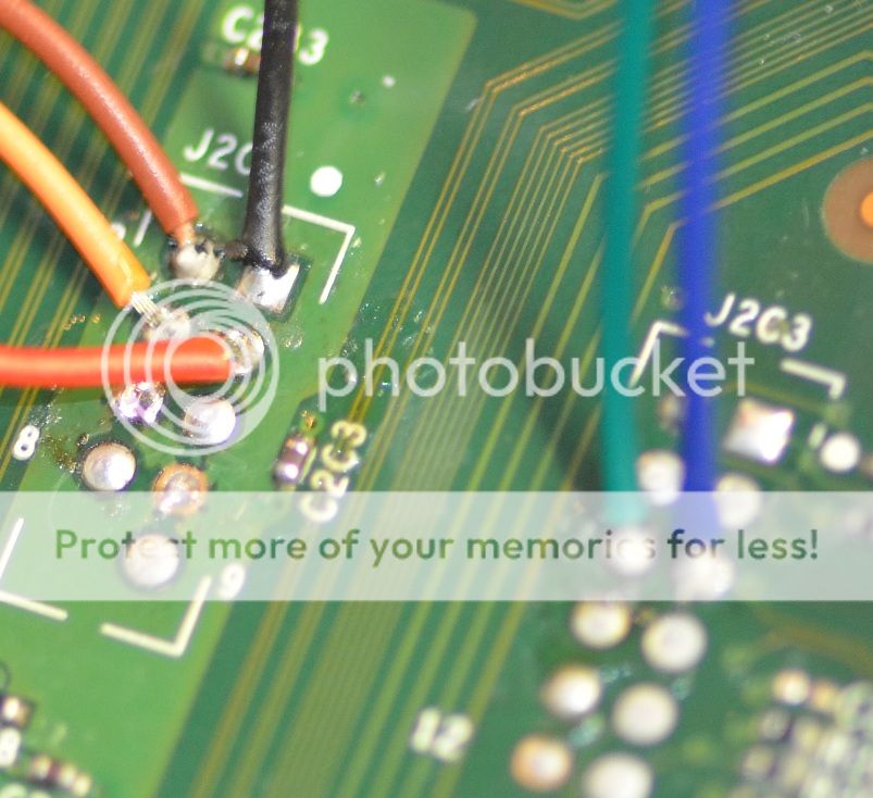

Yes the nand - X is recognized. Here is an image of everything cleaned up and trimmed down. Still 0x00000
Oh and I moved the ground to the ethernet port to ensure a solid connection before someone comments about that.
