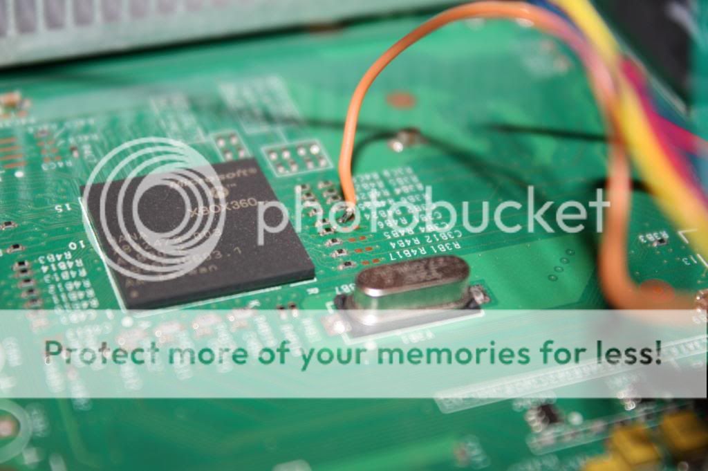

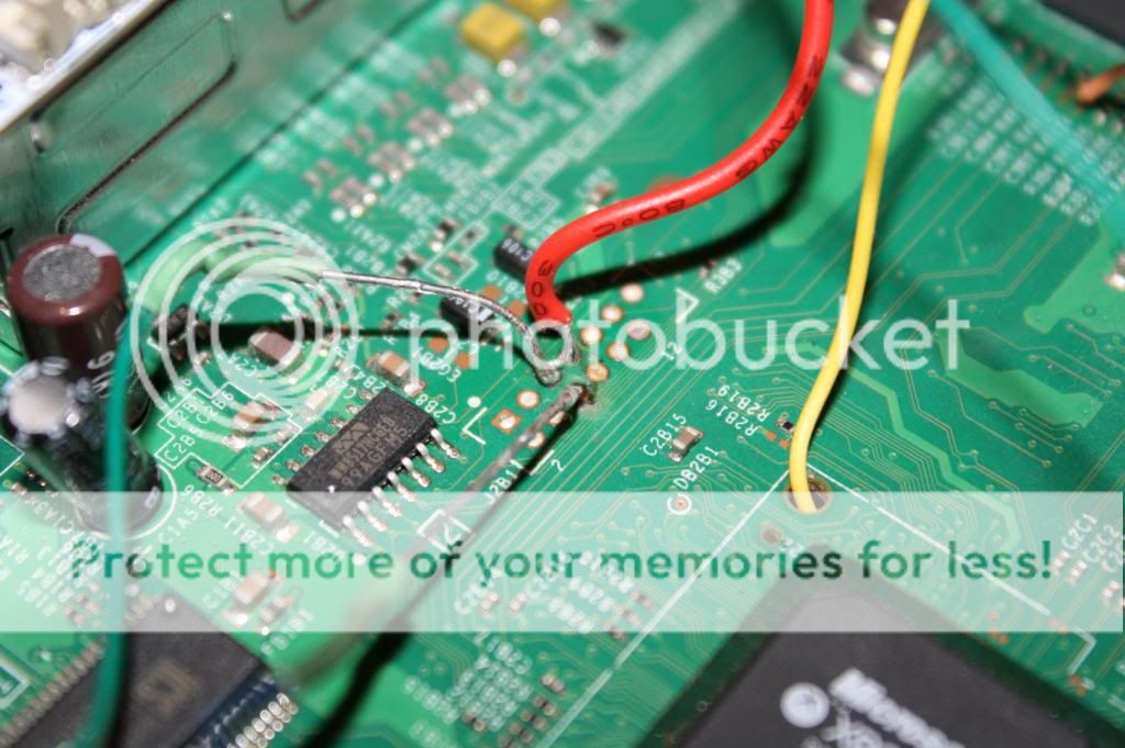

I am new here and need some help on a Jasper RGH 1 16mb with bad blocks.
I did not check the Jasper at first to see if it was a big block or small block as you can see in teh log. Stopped the read and powered up console to verify it was a 16 mb and sure enough, no onboard so assumption was right.
I then proceeded to read and bad blocks came up. I stopped the read and checked wiring, solder points.
Still same. So I tried to read as a 64mb and still errors and bad blocks.
Pretty well tried everything, different Jrunner, different PC and still have bad blocks and ultmately prevents the Jasper from powering up at all.
I flash the updflash bin file and wont boot. Flash xell/ecc boots everytime instantly. Falsh to stock and boots perfectly.
I have done many Jtags/RGH and usally depend on Jrunner to rebuild but does not rebuild the blocks in this instance.
I am an electronics technician and have extensive knowledge and expertise in soldering/diagnostics but do not have much experince in the software/nand building department.
I will apreciate any help or someone who could possibly help rebuild a working nand/Updflash bin file that I can flash to my Jasper.
