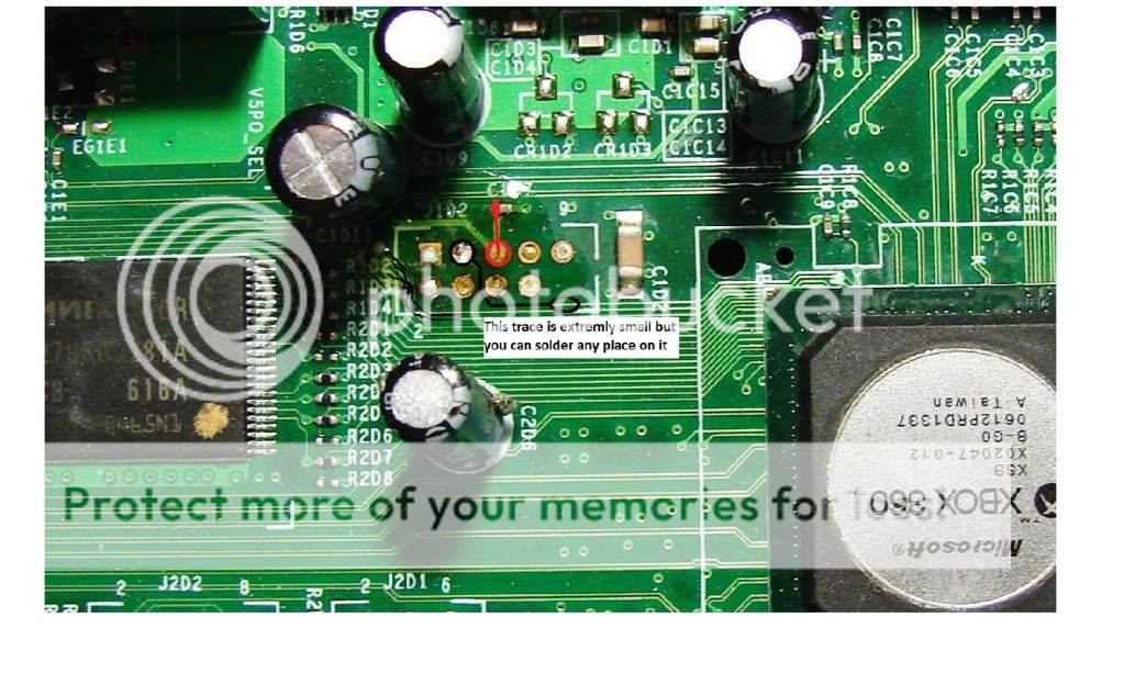

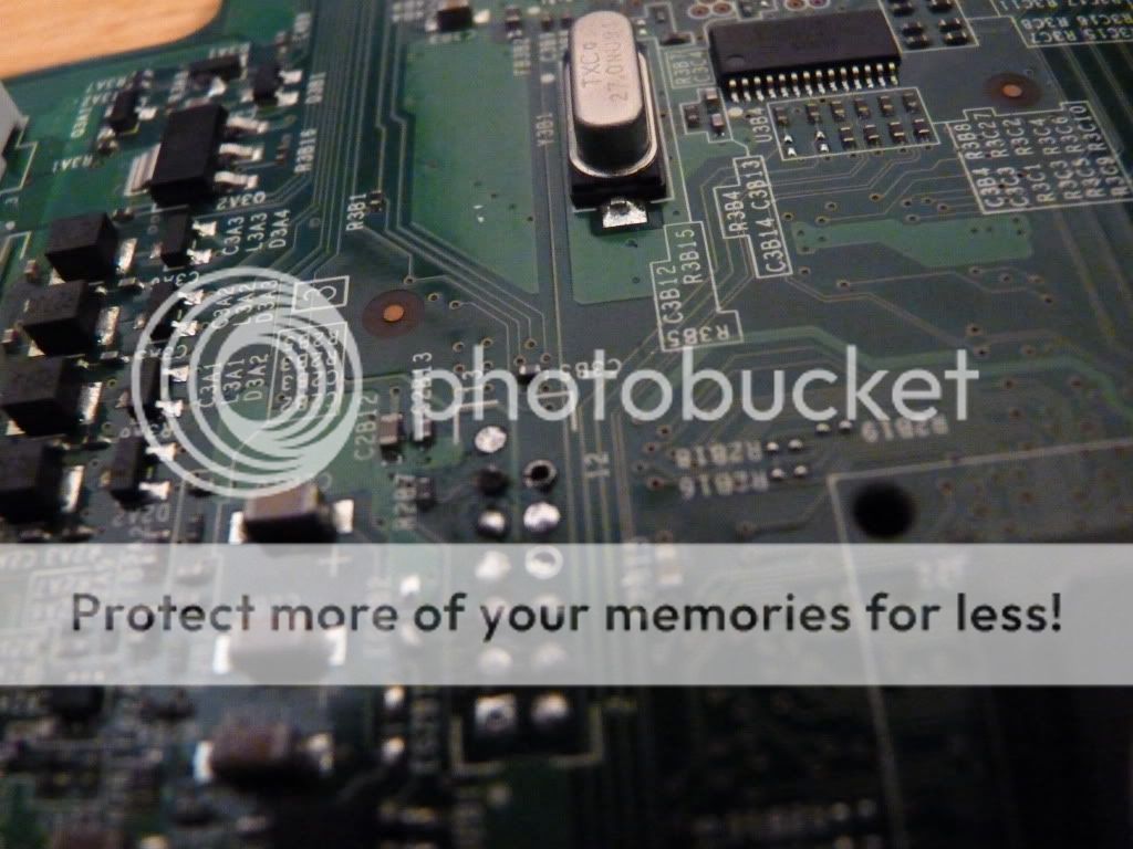

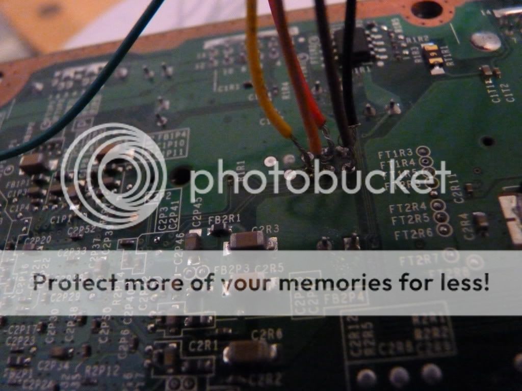

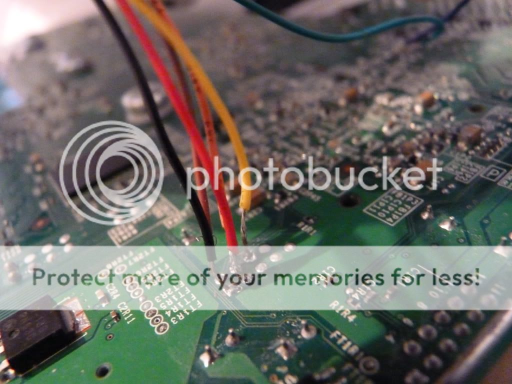

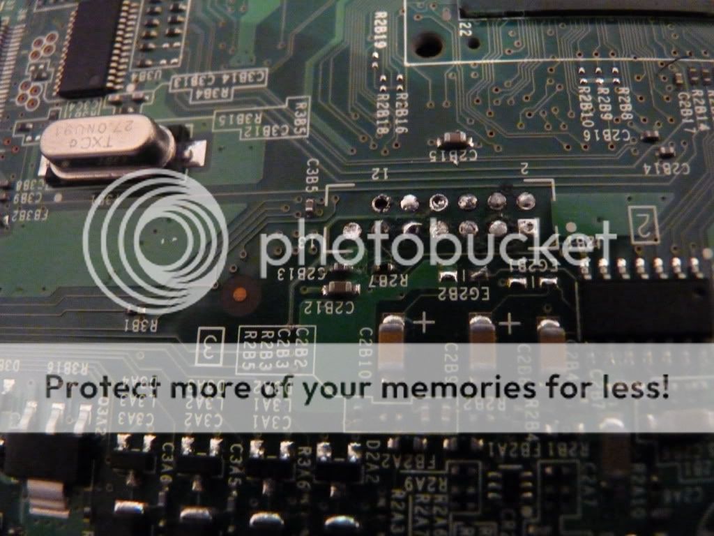

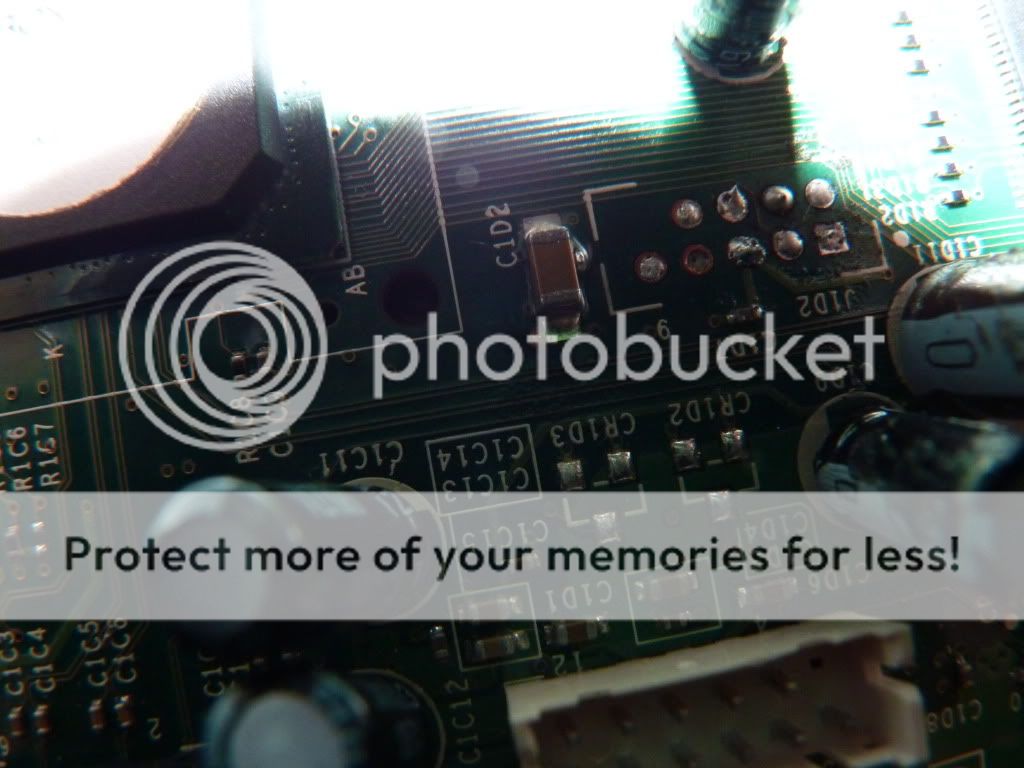

ok so i solder the wires direct to the mother board but i have burnt one r more of the traces on the j1d2and may of bunt a tarce on j2b1is there any wa can fix this and i will try and get pictures up as son as i can but my camrea has broke so n for repairs also its a xenn mother board and if ythere is a diffrent way i can dump the nand can you put ptures with coulored lines of what wires go where

i have attached some pictures of the problem hope this can help you out with resoleving it

Just flip the board and solder to the alternative points at the back that's of course assuming that there is no damage has occurred beyond the soldering points on top.

If you havent burned a lot of the trace you can get an exacto knive and scrape a little bit off to expose the unburned trace and repair it with a conductive pen or make sure your solder touches the trace.

if you can post me hi res pic i can tell you what you need to do to repair it

so which is the trace that is burned?the little squiggly lines on the left?

those have to be repaired for the console to work they are super small if you haven't noticed they connect you nand to your southbridge without them being repaired the console will never work
