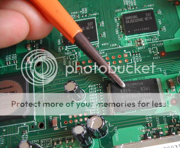

The link is an image of the nand chip so you know which ones to short to put the nand in recovery mode....
Just use a screw driver and lay it across 44-47 and it will be put in recovery mode and let you right to the nand
This one right

Trying to SHORT the pins. Not bind them together. Way esier just pressing a flat head against them.

Here's how I do it sorry fort the late response your going to need an extra set of hands or just be super cool. Unplug the box, lay the screwdriver or metal object that you are using to short it. I have used anything from an exacto knife, tweezers to a paper clip. Anything small enough to bridge only those four pins. While your object is bridging the pins plug the box in. I like to remove it as I press read NAND.

Try connecting your usb spi flasher to the pc and check that it shows up in device manager under memory access. Then plug your power supply in and read nand. (i found that alot of the time my usb spi wouldnt show up if i had the xbox already powered)
IF your nandpro reads cannot find flash config then you need to bridge pins on nand.
I use a bare wire and lay it over all the pins on the side that doesn't have the dot(pins 25 - 48) and watch the psu go red, then switch power supply off at the wall while holding the bare wire on the nand. Then switch the power supply back on and hopefully the light stays orange. (if not you will need to insulate pins 36 -37 and try again until you get orange light).
