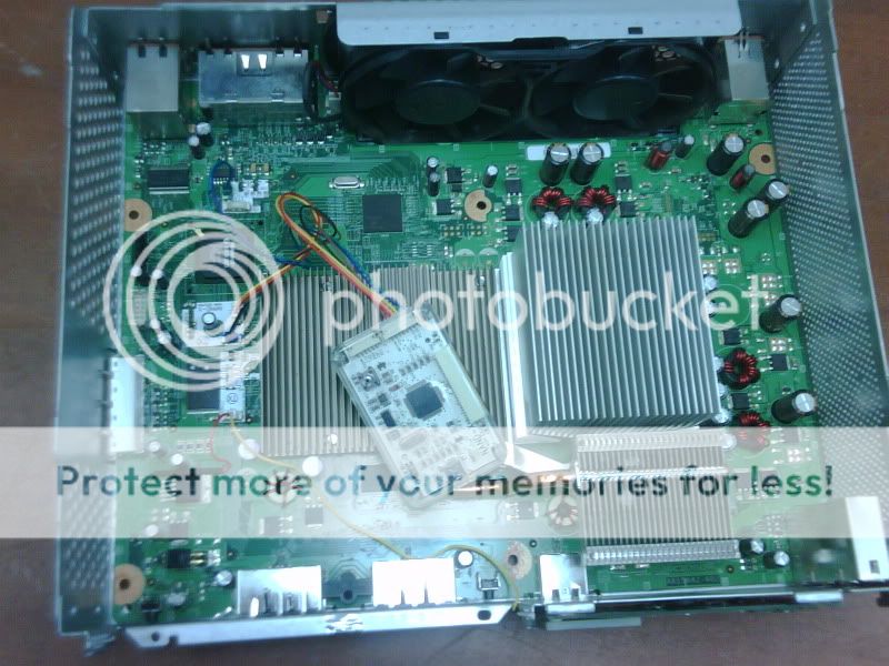

So i finally got around to installing the nand-x on one of my jtagable xbox's. I soldered everything correctly and hooked up the reader.
Here's a screen shot of all the errors i get.
http://i145.photobucket.com/albums/r217/Carnifreekshow/wtf.png
I get error 204, 210 and 250. I read that 250 is all 0's which i'm not really concerned about but all these errors make me think i have something hooked up wrong.
The xbox is a Jasper 256mb, and i'm using windows 7 64 bit. Here's a picture of the nand-x boards soldered in.
http://i145.photobucket.com/albums/r217/Carnifreekshow/IMG00181-20101111-1047.jpg
Please let me know if you need any other information, or if i have to make my own thread for this issue.
Thanks in advance.
