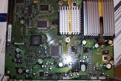

sounds to me like another +5v pin mishap. PLEASE PEOPLE INSULATE YOUR +5V, thats if you dont have a CE (or 1.6 box).
tank

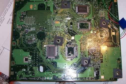

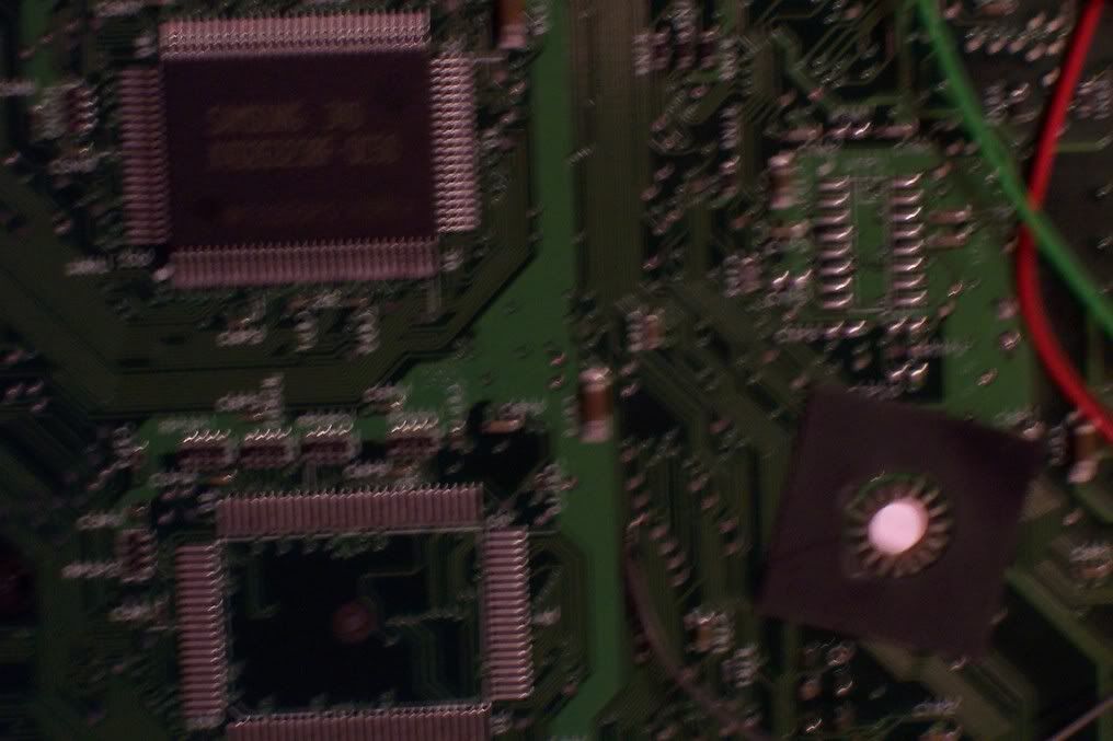

anyway, here are pics of my mobo
thats the best i can do for the second one.
btw, notice how the MCPX is brown in the center. this is about where the smoke was coming from. btw, why did xecuter add that 5vpin if if could cause probs like this? seems like an accident waiting to happen.
