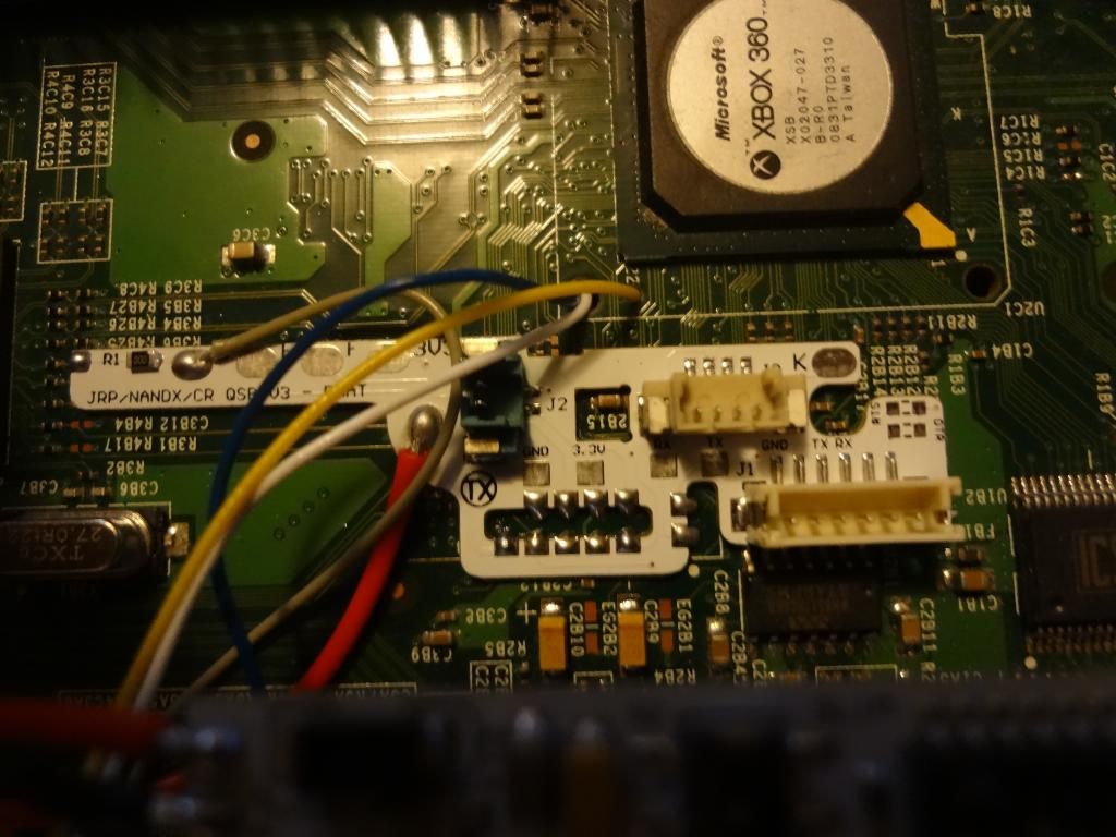

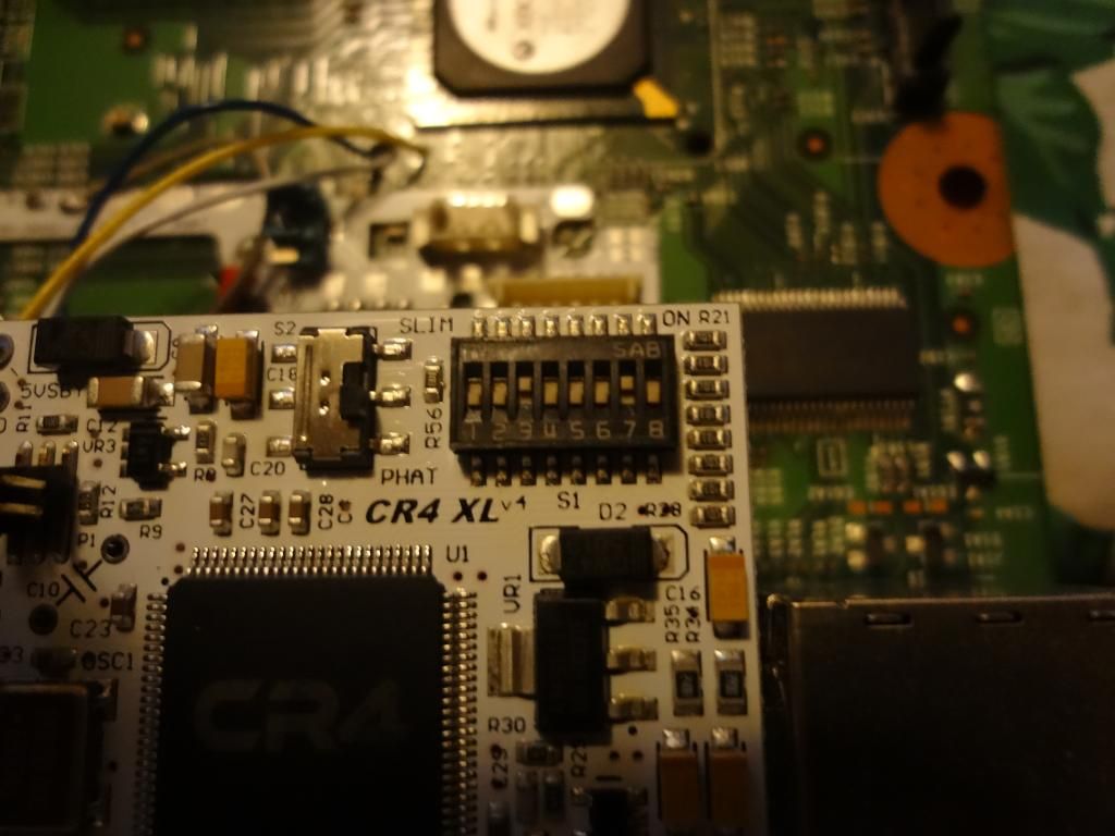

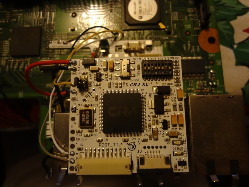

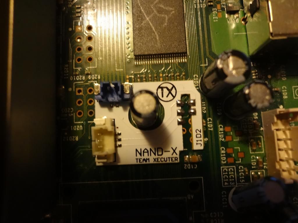

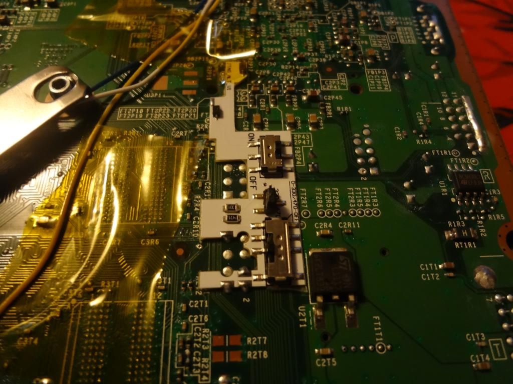

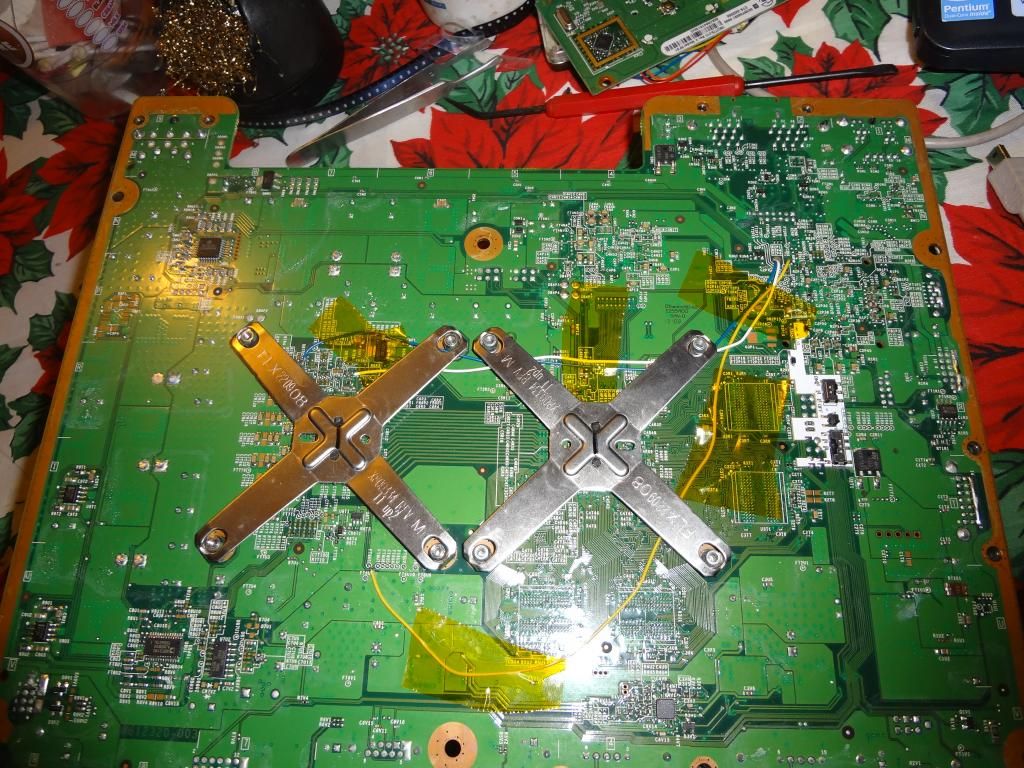

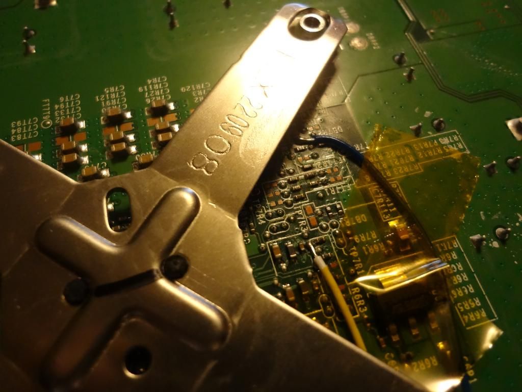

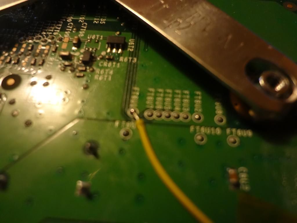

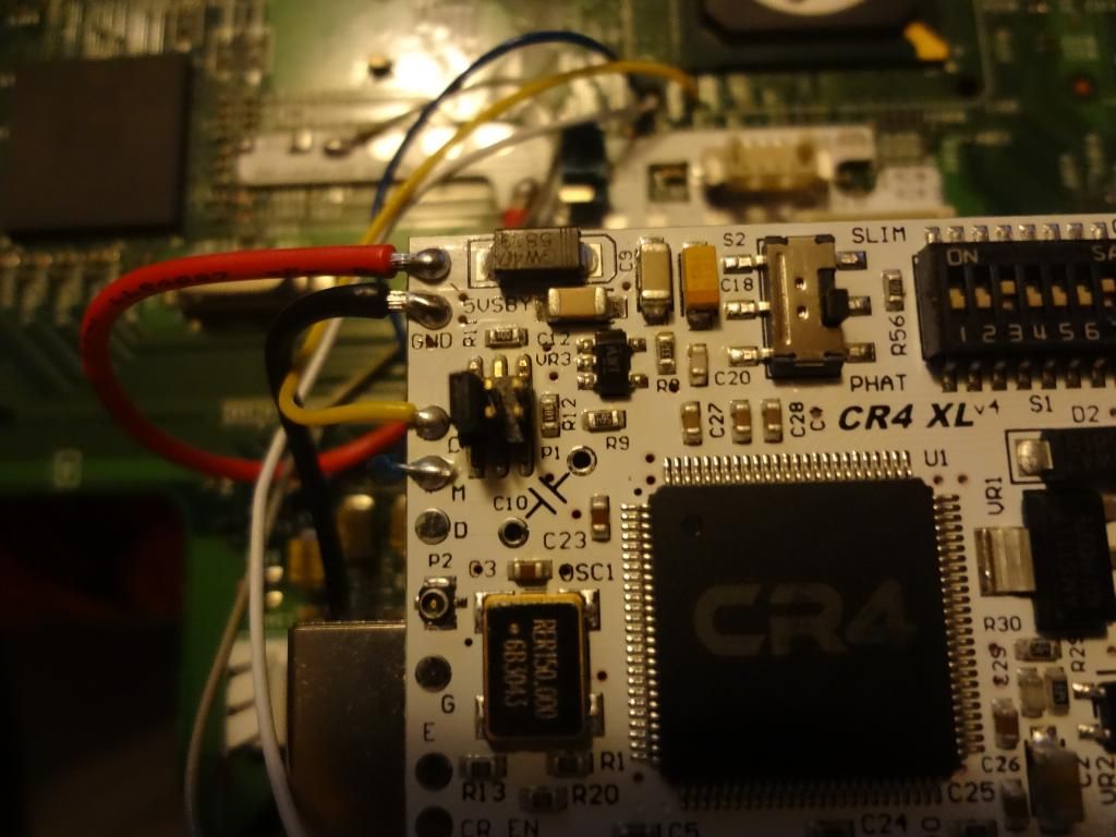

So I installed a CR4 on my Opus about an hour ago and at first it didn't boot, but with the quick flick of a dip switch, i'm getting instaboots all the time. I used all standard wires, no cutting, and used the JTAG QSB without Aud_clamp. This was a pretty fun install, and wasn't much work getting amazing boot times!
  • Dip switch settings - 3,7
  • Postbit jumpers - 10 Ohm
  • Type of CPU_RST Cable Used (Default/Pro Cable/IPEX) - Default
Here are a few pictures of my install

Nice Job looks really good.. These are fun to install.... As ant said shorter the leads up and it will be perfect Nice Install
