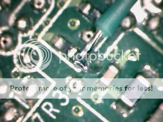

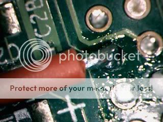

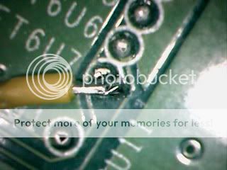

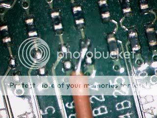

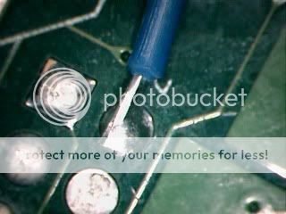

Only just got back on the falcon fault finding! Little one is in bed!
Here are the photos of soldering.
Not bad me thinks any experts got an opinion?
Right going to do the thermal paste now..
Cheers..
Edit - The new thermal paste did the trick, fans have stopped blowing all the xmass cards off the sides so im happy! Thanx for the help..

Op thats actually nice soldering.. Well done.. Which solder (mix) do you use and iron?
Thanx.. I have a variable heat soldering station that i have set to optimum temperature just through trial & error. Think i got it from Maplins. Not sure of the ratio of the solder sorry. Also use no clean flux pen, again its old so sorry dont know the type as label has faded/worn.
