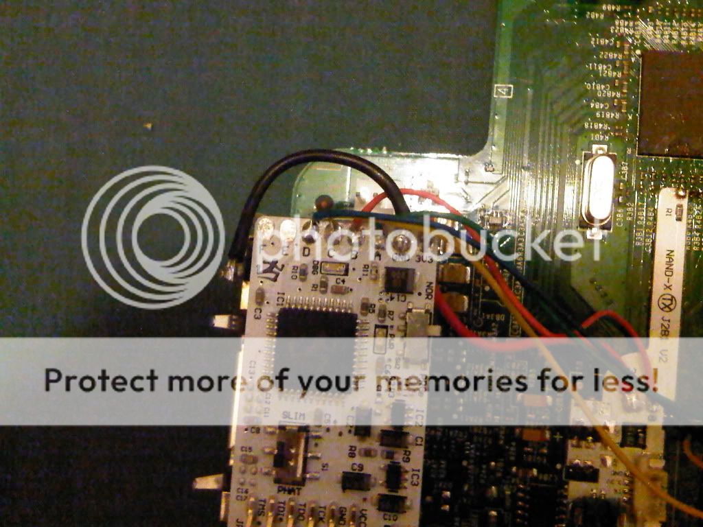

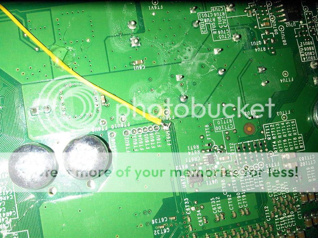

Here are the pictures of the wiring

Yellow wire on the wrong point....
Should be on FT6U7.... Should always check wiring...
Also your Point B, seems wonky compared to the pic and the way mine turn out. Notice the QSB cuts the R4B25 writing in half. Yours is completely visable. Seems off kilter

Thank you, i don't know how i missed that, i thought i did check but obviously not properly. Its now working.
Thanks so much.
