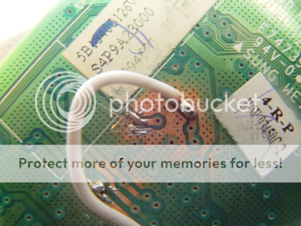

correct if the via lower barrel is still in tact by the pic you posted it looks like it's missing

well is the copper pad still their or is it missing ? if it's their i mean you can actually see it or not try scarping it gently with a razor see if it becomes shiny, if it does then the pad is fine and you just have to repair your cuts
as for repair teajunkie is closer to you then i am

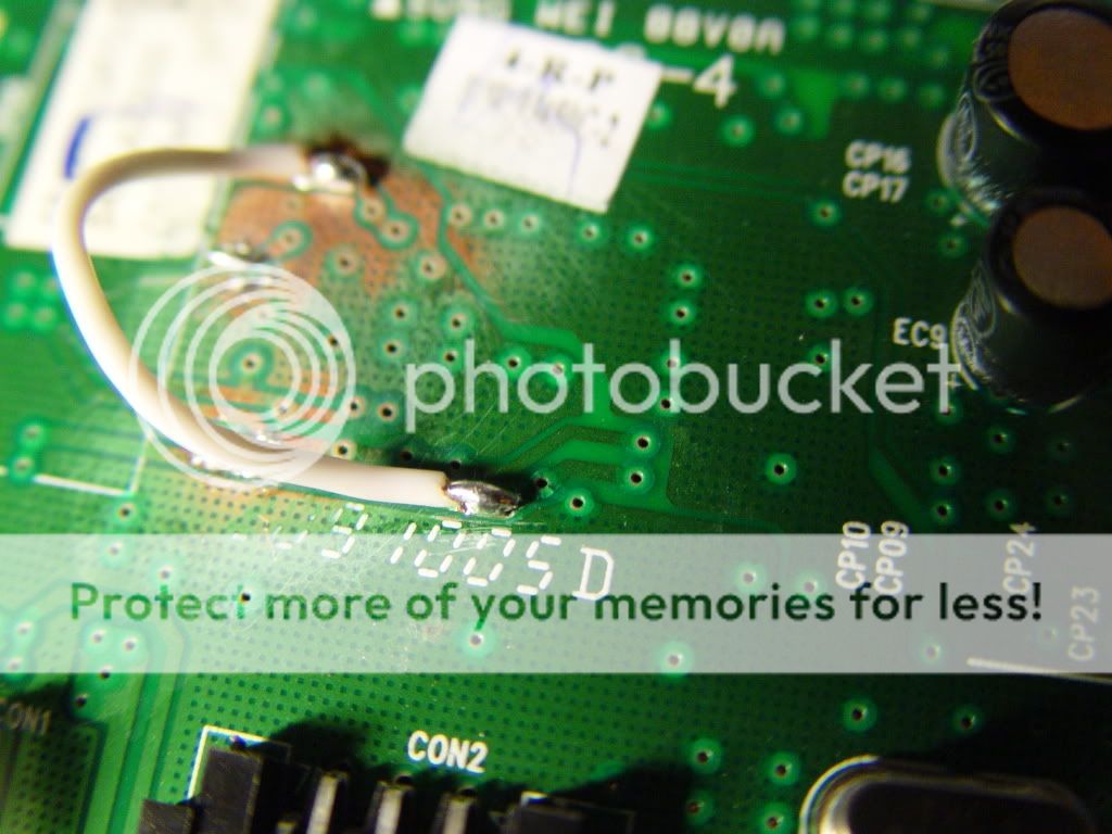

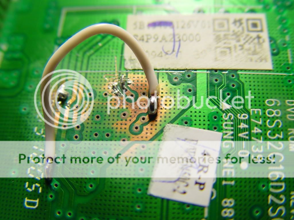

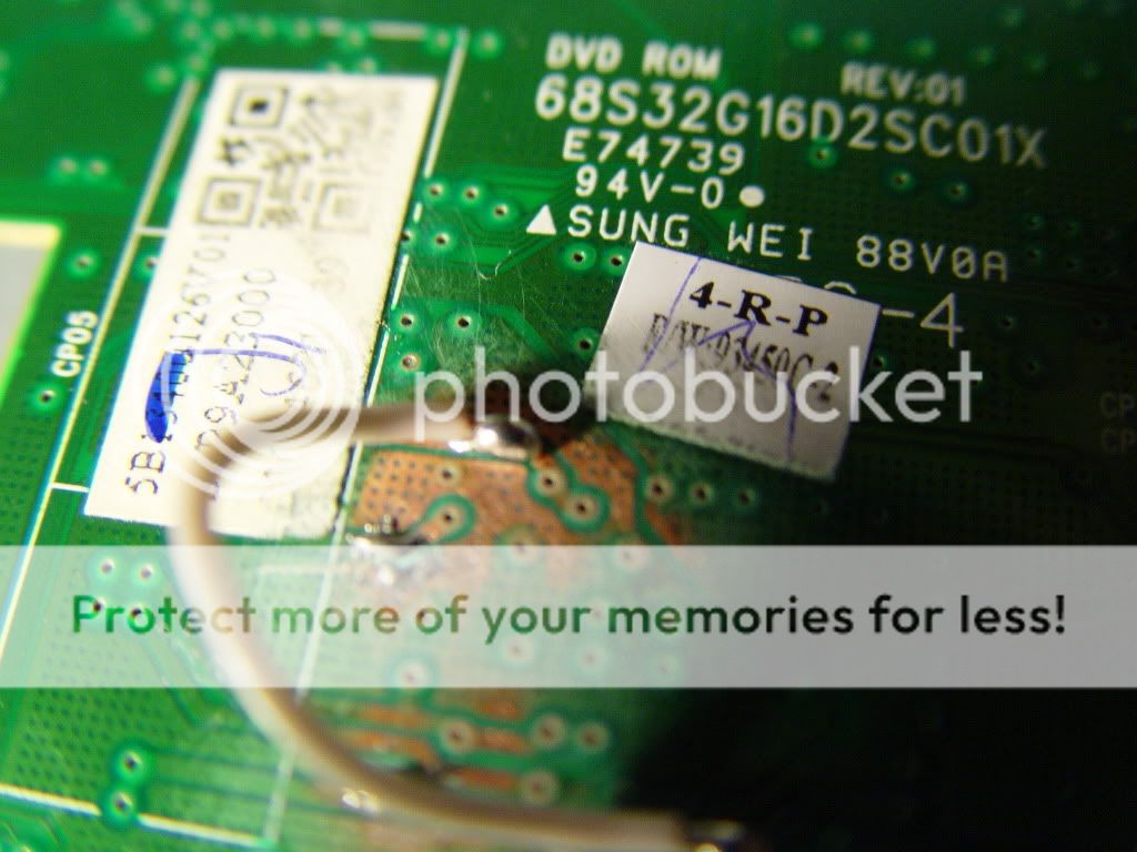

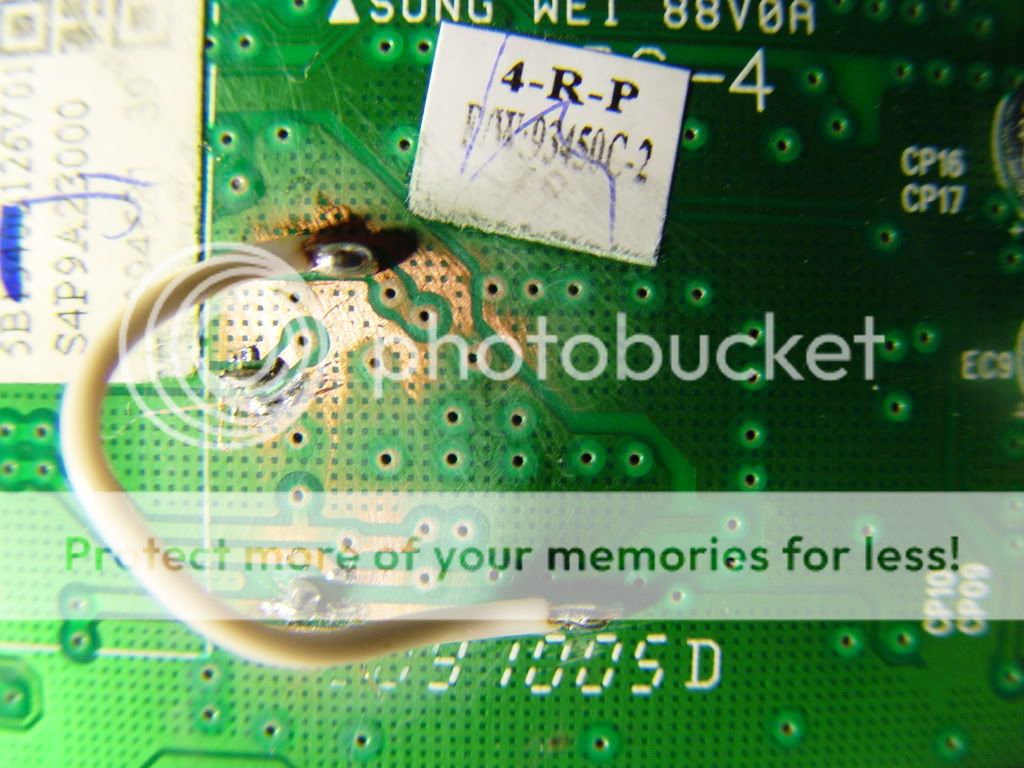

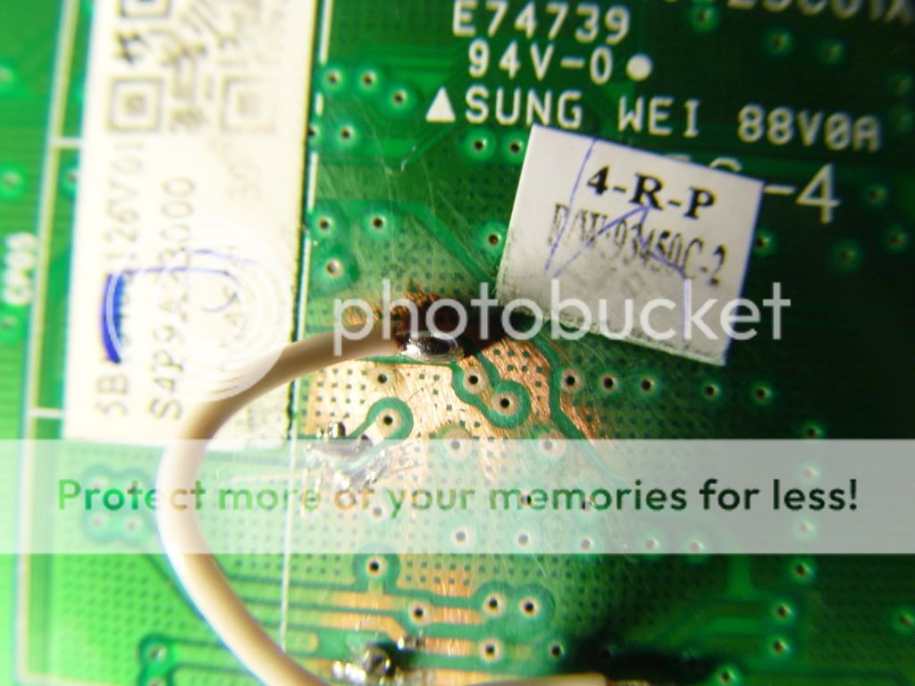

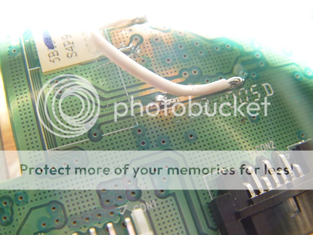

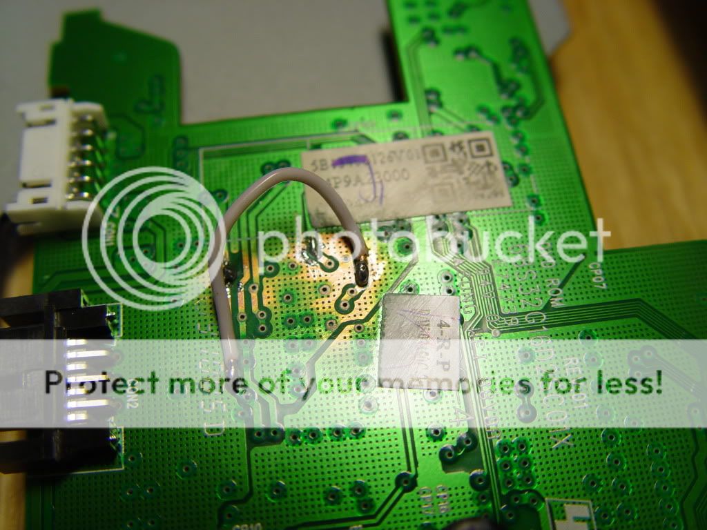

Ok guys here are some of the repair Pics that i did today at work
as Far as i can see there are no Short Circuits.
Was a little Hard to get the Angles on the Solders so i took a few =/
(Sorry if loading time is slow....)

if the 101 pad was not shot and you were able to do this
then remove that jumper wire as it's not needed

Xmods
Dec 9, 2002
1,431
lol i could so fix that :p

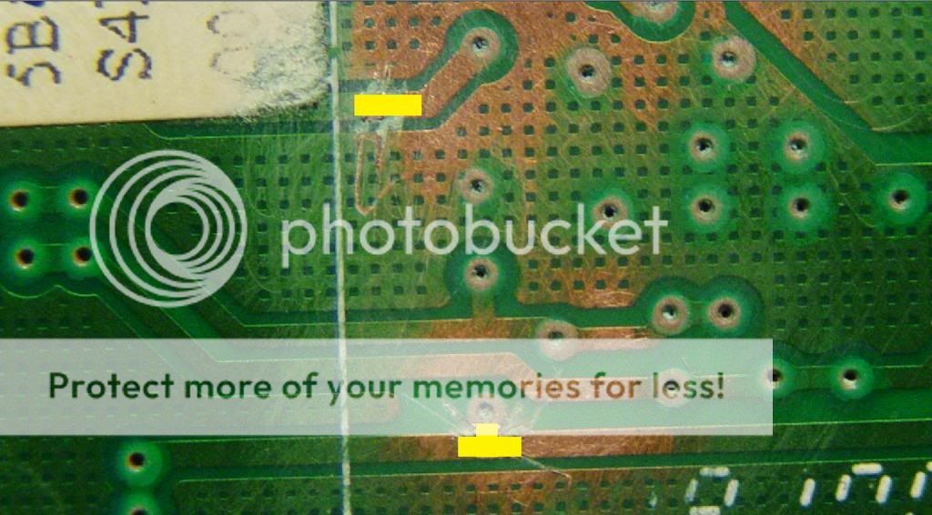

was told only 1 leg was missing look what removing the epxoy reveals
