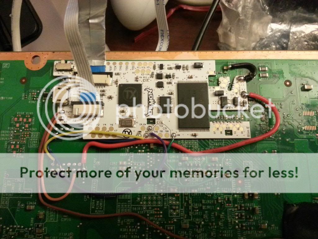

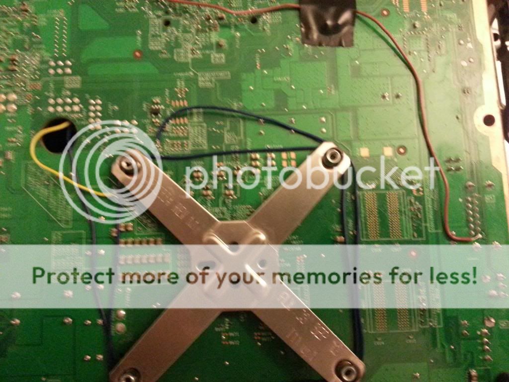

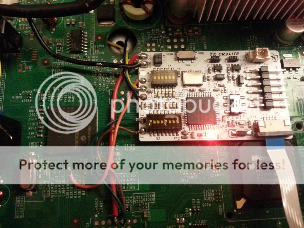

Recently purchased a trinity slim xbox. Bought a cr3 lite and demon. Ive installed many coolrunners so Im pretty comfortable with this motherboard and soldering. Coolrunner was installed first. Got cpu key and boots almost instantly. Tested the demon on my pc before installing. Everything worked fine. Installed without issue. Wrote stock nand with the demon light off. Boots stock fine. Write rgh nand with the demon light on. Cr3 lite debug light flashes but wont boot to the dashboard. Checked all my soldering. No bridging or shorts. No pads lifted. Just endlessly attempting to glitch without success. Can anyone help me out? Posting pics asap. Will post jrunner log as soon as I can. Thanks for any help. <a href="http://s247.photobucket.com/user/brianone24/media/20131004_022630_zps27538088.jpg.html" target="_blank"><img src="http://i247.photobucket.com/albums/gg135/brianone24/20131004_022630_zps27538088.jpg" border="0" alt=" photo 20131004_022630_zps27538088.jpg"/></a> <a href="http://s247.photobucket.com/user/brianone24/media/20131004_021734_zps71f7b299.jpg.html" target="_blank"><img src="http://i247.photobucket.com/albums/gg135/brianone24/20131004_021734_zps71f7b299.jpg" border="0" alt=" photo 20131004_021734_zps71f7b299.jpg"/></a> <a href="http://s247.photobucket.com/user/brianone24/media/20131004_021720_zpsf35d9459.jpg.html" target="_blank"><img src="http://i247.photobucket.com/albums/gg135/brianone24/20131004_021720_zpsf35d9459.jpg" border="0" alt=" photo 20131004_021720_zpsf35d9459.jpg"/></a>
