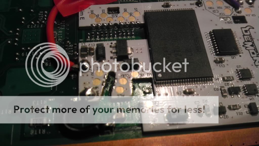

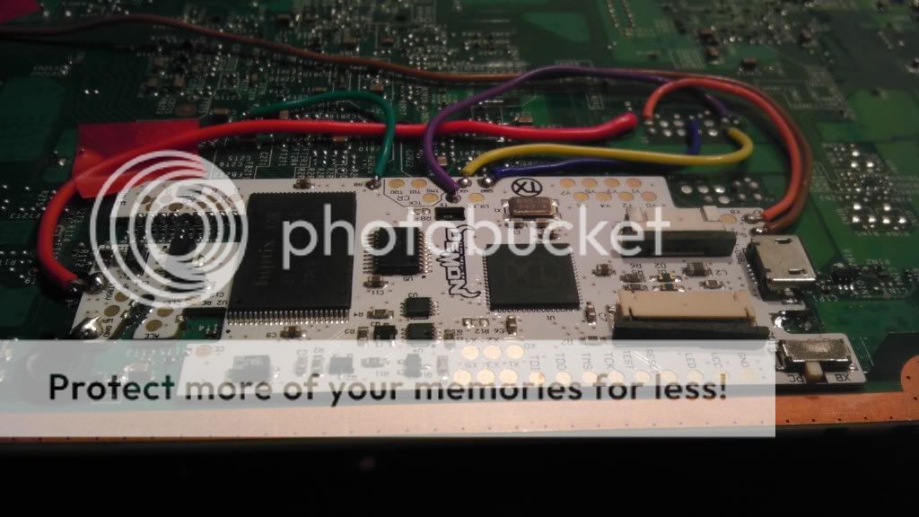

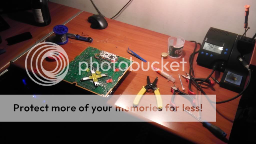

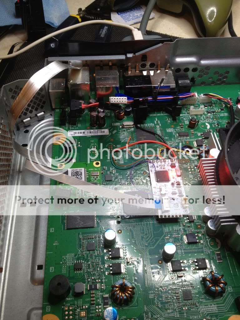

I had no problem installing demon Slim - just couple of tips:
PCB is quite large so you better use piece of both-sided sticky tape to hold it in place (pic 1) to prevent miss-alignment

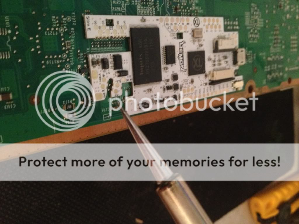

I tend to clean, flux and pre-tint points before (pic2)

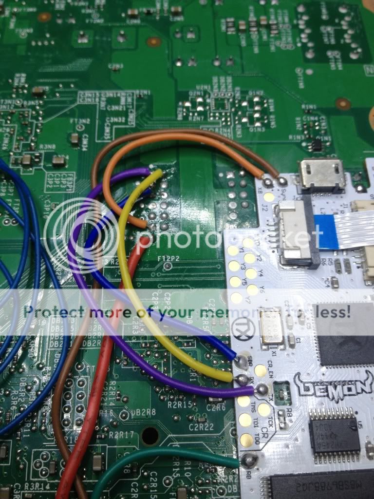

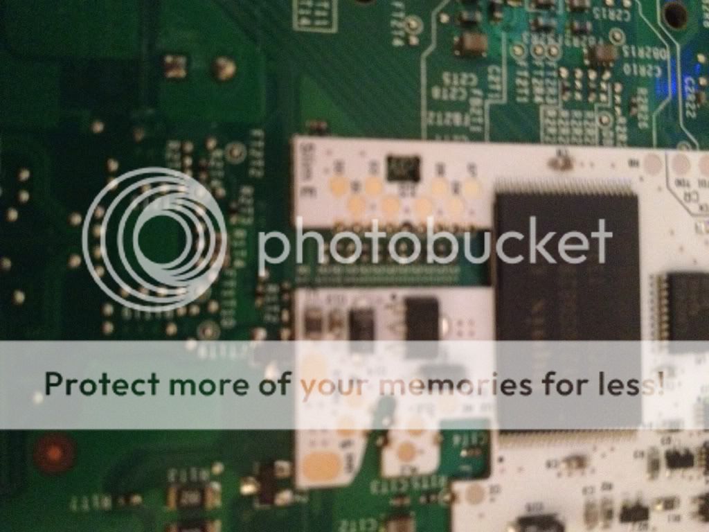

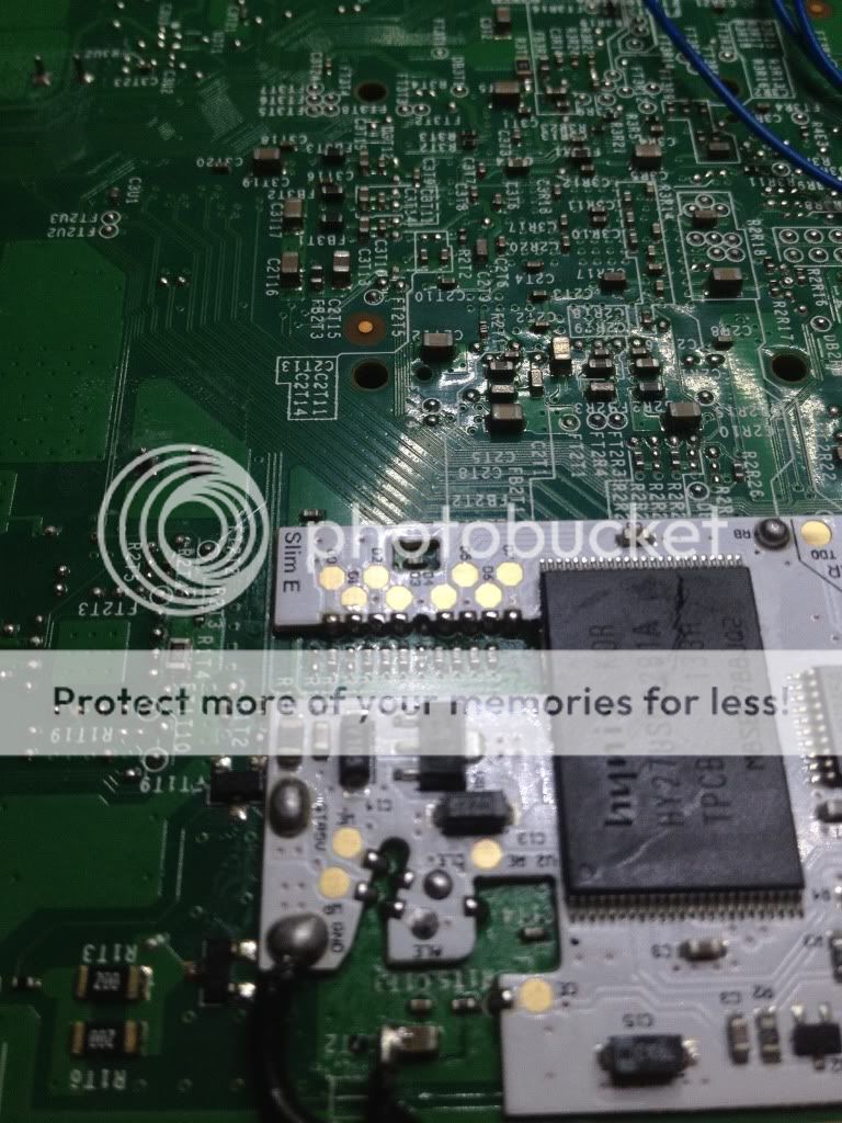

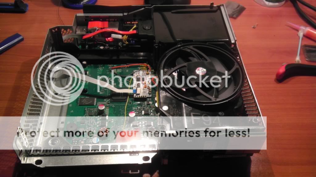

Points are smaller, but with a little patience the are easy to do (pic 3,4). There is no need to change to smaller solder tip,just steady hands and patience
Thanks for this great product, another success !

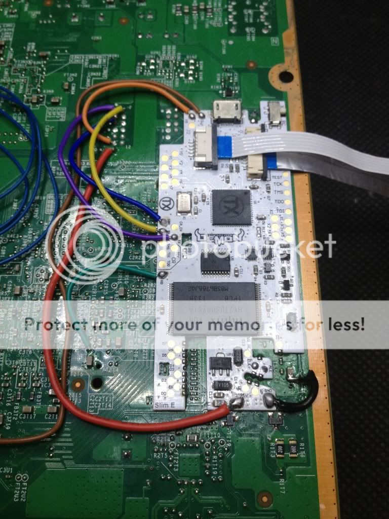

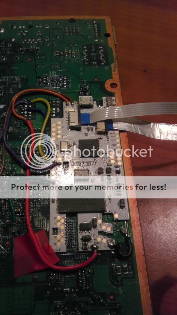

Hi guy, I don't have a demon yet, but decided to route the wires on a pic without needing to jump across other wires and also for a neater install. Anyway here is my take on the wiring.
This routing may or may not be possible as i dont know the length of the wires, however some wire stripping may be required.

Very nice install, very clean, I love it!!! Mine was sent to a professional to install it! I can't solder those small points anymore :(.

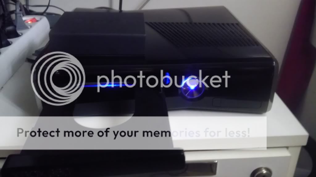

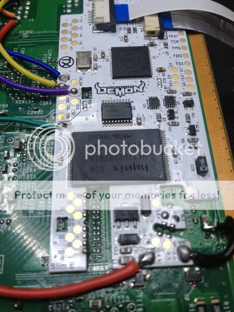

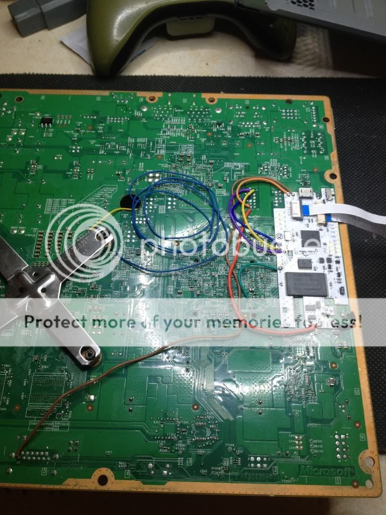

Pictures of my first install. Works Perfect.
Demon Slim & Cool-Runner REV.B
Quick Solder Points (Sorry bad pic)
Very Fine Tip Iron (Weller)
Quick Solder Points
Wires To Console
Wires To Console
Wires & Quick SOlder Points
Wires Including Power and Sync
Coolrunner REV.B (Wire To LEG For Power On)

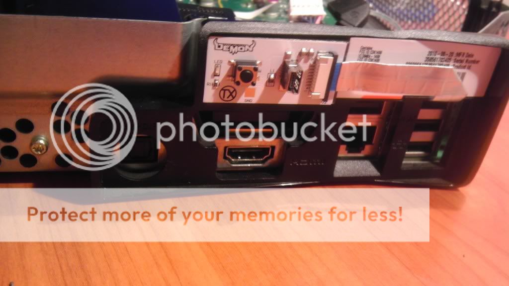

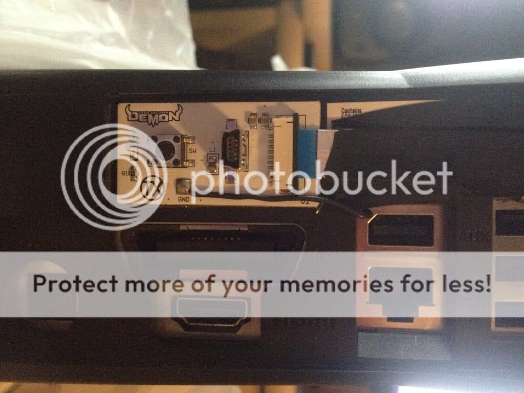

USB Port & Switch
