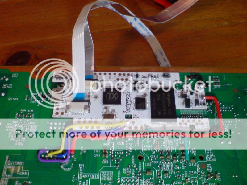

Pics of my demon install. Soldered with fine soldering tip 18 watts.
Before:
After:
Install works 100%. Glitch times could be better though. Around 5-8 cycles of green average. Don't like the coax wire because it ripped of my solderpoint once.
blober54
at last, someone who has brains and doesnt cover their joints in glue but used tape
I salute you
Thank you sir, I always use electrical tape when I do my installs, have a roll sitting by my soldering iron all the time lol.... helps insure when theirs issues it cant be grounding out, but if it is you will see it since the tape will have a wire poking through lol

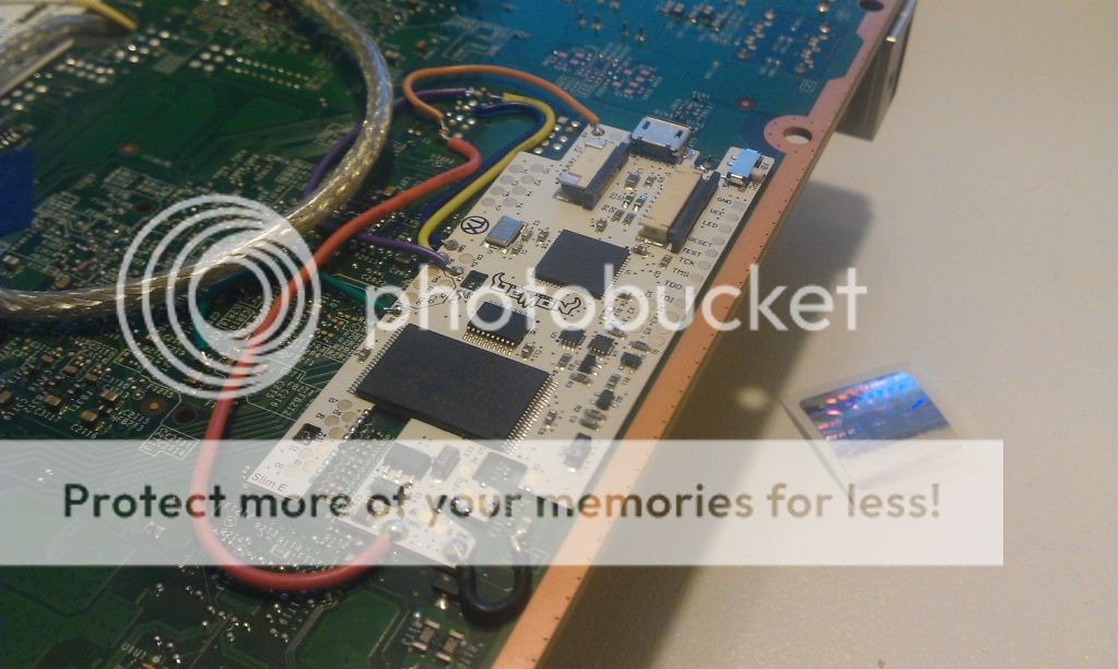

Used double shielded cable first, but it didn't glitch so I replaced CPU_RST with the slim cable. Boots now in 20-55 seconds. Also used QSB v2, that is why i2C_SCL and SDA are soldered underneath the mb.

Here is my trinity GoW Demon with CoolRunner rev C. I decided to dremel a very thin slot for the Demon USB board. I then drilled a very small hole for the GND.
-b0n3z
