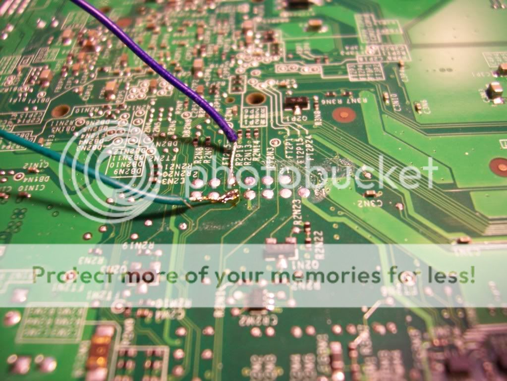

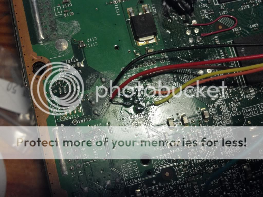

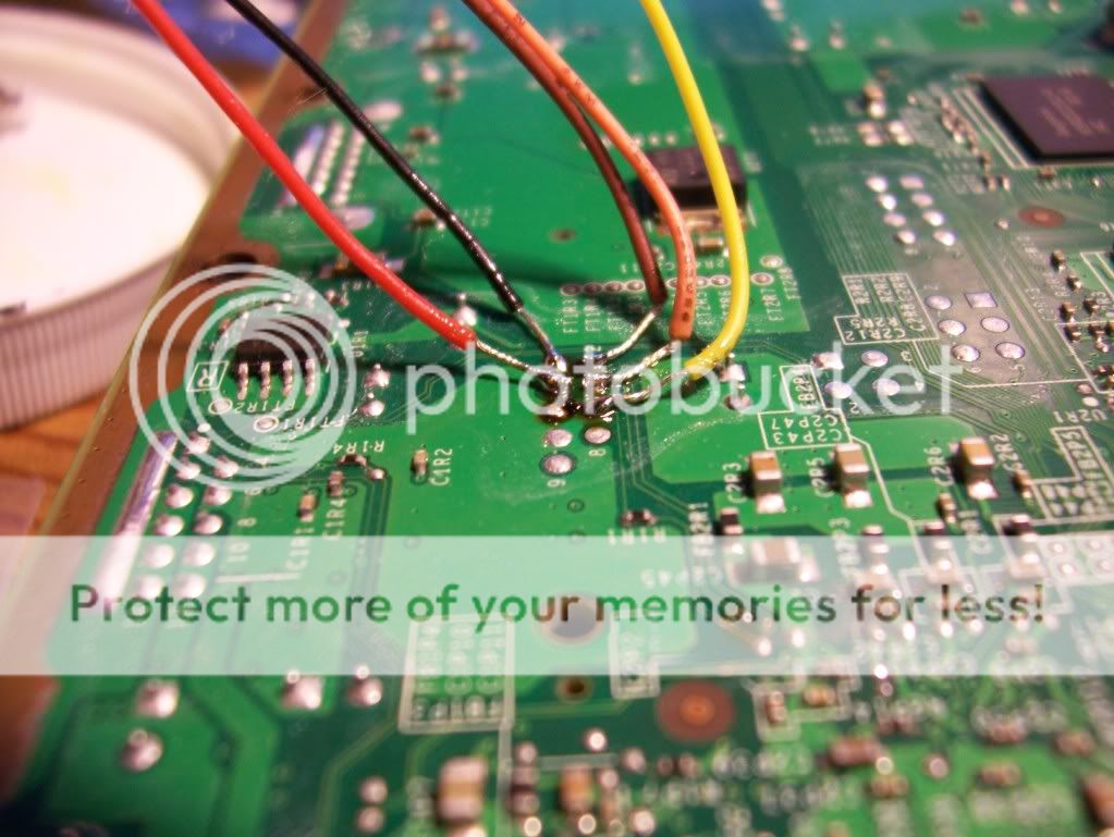

Any Ideas? Also, here's some pictures of my soldering:

EDIT: I hooked up the nand-x to my friend's zephyr jtag and got the same "can not detect" message. Here are the pictures:
Checked the voltage on these points, and it was the same as the other console, except for point 2, which read about 2.4 volts
