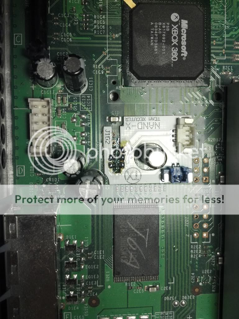

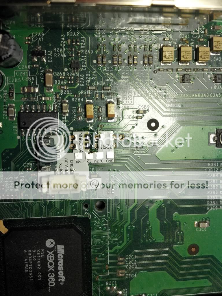

EDIT: Someone requested pictues of my QSB install, here are the QSBs installed:
Are you power cycling the NAND-x each time you plug in the PSU?
You're using way too much solder as well. Need about half than that or you run the risk of interference (bad blocks).
Have you used this NAND-x before successfully?

Should I have the nand x plugged into the computer before I plug in the xbox power supply or vice versa? Also, should I try pressing the reset button on the nand x?
Also, if it makes any difference, the console still boots fine, no RROD errors or anything like that, even after soldering and de soldering the wires/QSBs
I would always do it in this order : PSU first, then plug NAND-x into USB.
You shouldn't need to reset the NAND-x.
I'm assuming these consoles work ok?
I'm still worried about that point which should be 3v. Can you measure J2B1.7 and see if your meter picks it up as 3.3v?

I measured it with my multimeter and it reads about 3.3 volts.
Which means that your 2.4v reading is sub-par and may indicate an issue with either solder or the point itself.
Unless you have another known working NAND-x there, it's hard to say either way.
