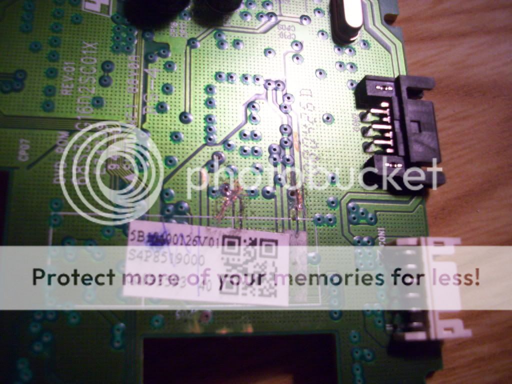

help fixing what someone else did
ok so i had someone bring me a 360 ith a 7 series lite-on they tried to dump and flash themselve but screwed up cutting the traces so now its up to me to try and at least dump the key to spoof to another drive if needed i have a vampire probe and maxius pro power dongle heres some pics of the board

That looks like a soup sandwich!!! lol

It looks doable, its bad but i wouldnt say its beyond repair, if you have any problems with it let me know as i may be able to help after having to fix the same sort of thing

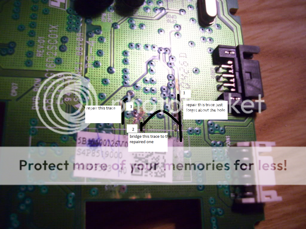

there should be alternate soldering points on the other side of the PCB, as it looks as if they ripped out point 101
i'm searching for the link i just saw the other day

that should be the best way to repair it if your vampire probe wont work then just use the 7 series probe to exract the key, if the hole next to number 3 is to damaged let me know and i'll tell you where to bridge that trace to
