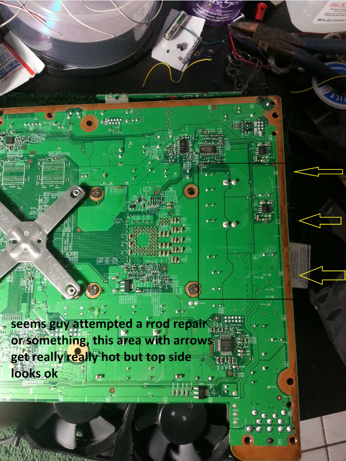

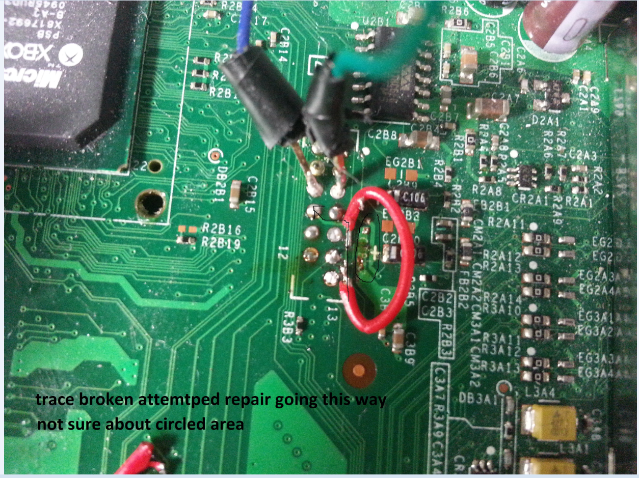

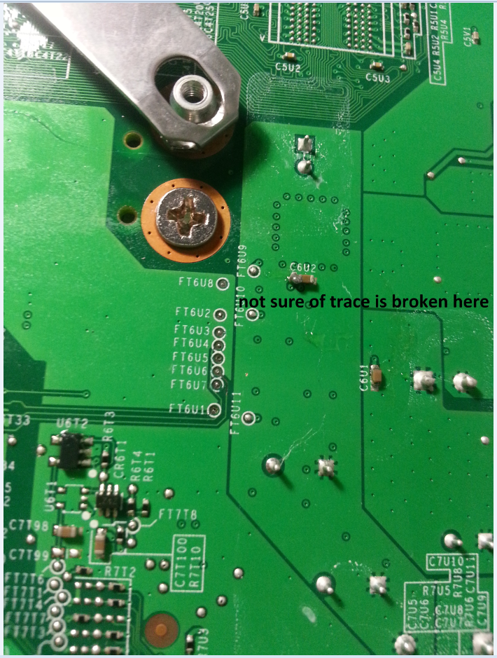

i have a customer just brought me a jasper he tried to R-JTAG but cause max damage so im trying to repair the traces and ut boot but it get stuck on the xbox360 screen after the green lights? i know most broken traces and stuff either cause red lights or errors but on this one doesn't it starts fine then get stuck there. what you guys recommend i should try before i tell him to put it in garbage.
update: nand is reading fine so far

i have a customer just brought me a jasper he tried to R-JTAG but cause max damage so im trying to repair the traces and got it to boot but it get stuck on the xbox360 screen after the green lights? i know most broken traces and stuff either cause red lights or errors but on this one doesn't it starts fine then get stuck there. coolrunner already used on another board and qsb discarded since where burned badly.

i will today and replace it with i guess 4 other screws and washers but the weird is i tried putting a chip to see if even boot to xell but with chips on it turns off immediately, when i take the power from chip, it stays ..... nand read ok but i guess there has to be another physical issue somewhere
