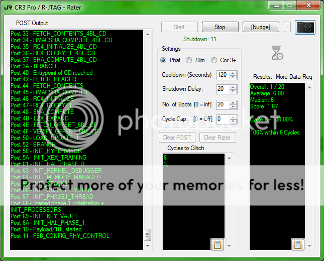

I put that there as a footholder because I was on my office laptop, I went back through the solder points on the post out and used the suggestion above and it booted to xell finally. Cold it takes 6-7 cycles, warm takes 2-3 with dips 5&7 on, 1.2v bridge, 330 cap, and 3-way switch to the left. Another odd thing is rater is not shutting the console down or maybe I am misinterpreting the shut down process. Either way it will not boot to xell on dips 1-4 (each individually) & 7 with the current 1.2v, 330 cap, and 3-way to the left, only boots to xell with 5&7 on. Here is a pic of the most recent rater:
For some reason I can't upload it and using the link from photobucket says I exceeded privileges so here is the link:
http://i1076.photobucket.com/albums/w459/cynder9792/MyRaterScreenshot5amp7330o_zps3b105e01.png
EDIT: also thanks to Maveriick for the suggestion

The console will only turn off if you have the green nand wire connected to jrpv2 and the nand point on motherboard.
I leave my nand cables in untill its finished. With the nand cables in you can do a proper rater and check your results
Reactions: cynder9792

Any suggestions for my settings? Again it is a falcon mobo
DreamZ
Dec 8, 2009
1,240
Essex UK
www.ixtreme.talktalk.net
Once you have your nand wire in I would just set boots and a cooldown period and rate it testing diffrent settings based around what has worked well for you so far.
I find on falcons the 3-way set to 0 has helped me in most cases.
Best to set 10 boots and maybe a 120 or even 60 second cooldown and run it through.
If you notice alot of HWINIT try 3way in middle

Most recent pic of rater output:
Nevermind for some reason my rater output pics are exceeding the quota:
http://i1076.photobucket.com/albums/w459/cynder9792/SS5amp7_330ohm_12v1_zpsb006663a.png
This is with dips 5&7 on, 1.2v, 3-way switch set to 330ohm/0
As can be seen, I am getting pretty inconsistent boot times. I have tried other dips 1-4 but I do not seem to be getting any better than the default 5&7 dips. I have tried the other 3-way settings and the best I got was 2 e79 errors on dips 1-5 & 7.
In addition, during the rater process I have noticed it skips post 13, 14, 17, a1 on every cycle and sometimes 19 also. On completion of most cycles I get "Panic - Alignment" on post 83 (I think). And the most fails comes from 0x022 which I saw means I am 1 past optimal boot times but when I switch to a previous dip either there is no boot or it goes past the results I am getting on default 5&7.
Any suggestions on how to improve my boot times or make them more consistent. Remove 1.2v bridge? Shorten cpu_rst wire? Or should this clear itself up more once it is in the metal shell? I ask this because I want to remove the mobo from the shell as little times as possible to access the bottom of the board, as in since I was still testing the rjtag qsb switch and have yet to even hot glue the cpu_rst wire in place in case it would make a difference in boot time. I am just trying to do this right the first time as it is my first r-jtag or any hard mods on any xbox for that matter...
