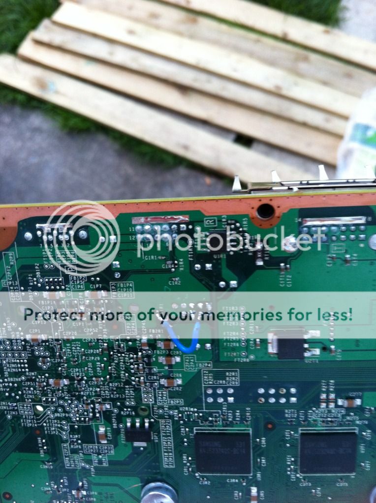

ive pulled this old jtag out of the back of my cuboard that i messed up a few years ago to have another go at it
anyway i found the problem id nocked the tiny r1r1 cap of so i bridged the connection and it now reads the nand perfectly and i got 2 matching dumps straight away
is this cap needed and would it mess the nand dumps up if it was missing ?
here is a pic
If it wasn't needed, it would be there.
r1r1 is a resistor. The 'r' at the start indicates this. I suggest checking another board for this resistor to get the value from it.
it's ok now i jtagged it anyway worked fine
then found a old board and took the resistor off that
and resoldered it back on just to be on the safe side
thanx for the reply though ;)
33Ohms is hardly anything, however it would double as a fuse if too much load went through. Therefore bridging it, long term, wouldn't have been advisable.

the r1r1 is 33ohms hope you replaced it with the right value resistor..
yea i replaced it with the 1 from the same spot on a xenon donor board
but im getting a new problem now, when the motherbord is out of the metal casing the temps stay around the 55 mark
but as soon as i put it back in the casing the gpu temps shoot up in fsd and just keeps rising any ideas
