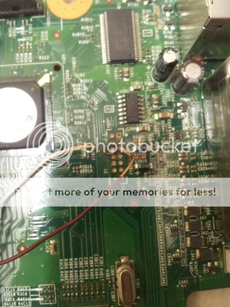

Here are some pics. It looks pretty messy due to the fact ive re-soldered loads of times and not been great at soldering. Using the multimeter I checked the undersideof the board to each of the wires (thats why I left a bit exposed) and there were not breaks or bridges.
---------- Post added at 14:32 ---------- Previous post was at 14:31 ----------
Jesus thats the first time ive seen it so close and it look quite sloppy but the contact is good on all the points.

Make sure you power cycle the console then the NAND-x. They don't look like NAND-x wires though. Have you ever got it to work ?
Thats the wires when im using an LPT cable. I managed to read the nand twice on my slim, compare and then it would'nt write or reader after that.

Was your soldering as bad with the first time you did it and the images you posted. It only needs a short and when powered on you can damage the NAND-x.
Failing that, try another USB cable!

Wow... dude I think you should practice soldering on a scrap board. I also highly recommend using Quick Solder Boards (QSBs) next time.
