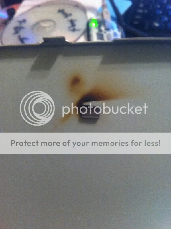

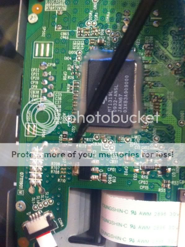

Hello everyone I hope I posted this in the correct area if not please feel free to move it. I have searched and I have came up with a couple of threads but it didnt give me the information I was looking for. The situation that I have is that I have a LiteOn 94850c drive that was in my old 360 that was never flashed or even open. The drive stopped working today as I hit the eject button and all it did was flash the green light in the ROL. I opened the console up and the drive and have the following pictures. It looks like the board shorted out. What I want to know is. Is it possible for me to retrieve my key and flash to another drive? I do have the soldering skills and technical ability and correct tools to do the job I just need help in getting my drive recognize by jungleflasher. It isnt seeing the drive and my ck3pro is not ejecting it also? Any help or suggestions is welcome.
here are the pictures
13,721
It looks like a chip lift job to me, contact Teajunkie if you are in the UK. He can lift the chip and get you the drive key, you will need another Lite-On drive to flash the key to though.
