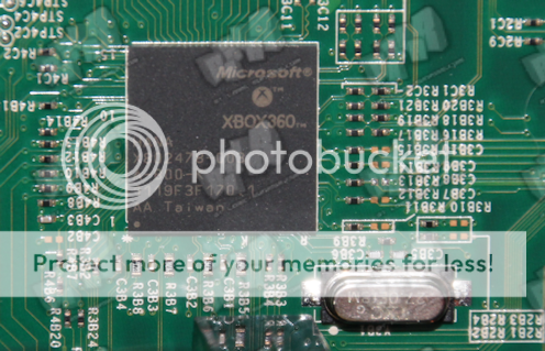

Just Bridged still no boot as you can see in this PIC some of the Points right next to the HANA Chip have no solder Now this Jasper had no Solder on none of them so i just put some on and put the wire on

Nope that looks fine. what your coolrunner light flashing or not?
Edit ignore the light flashing just read origianl post again.
Again jasper 16m can be a bit difficult to glitch try bridging the cap on the coolrunner, i know youve said youve done them before and there fine, so i have but ive did one the other day that was taking around 6 cycles to glitch (36 seconds), I bridged the cap and now its glitches within 10 secs most of the time.
