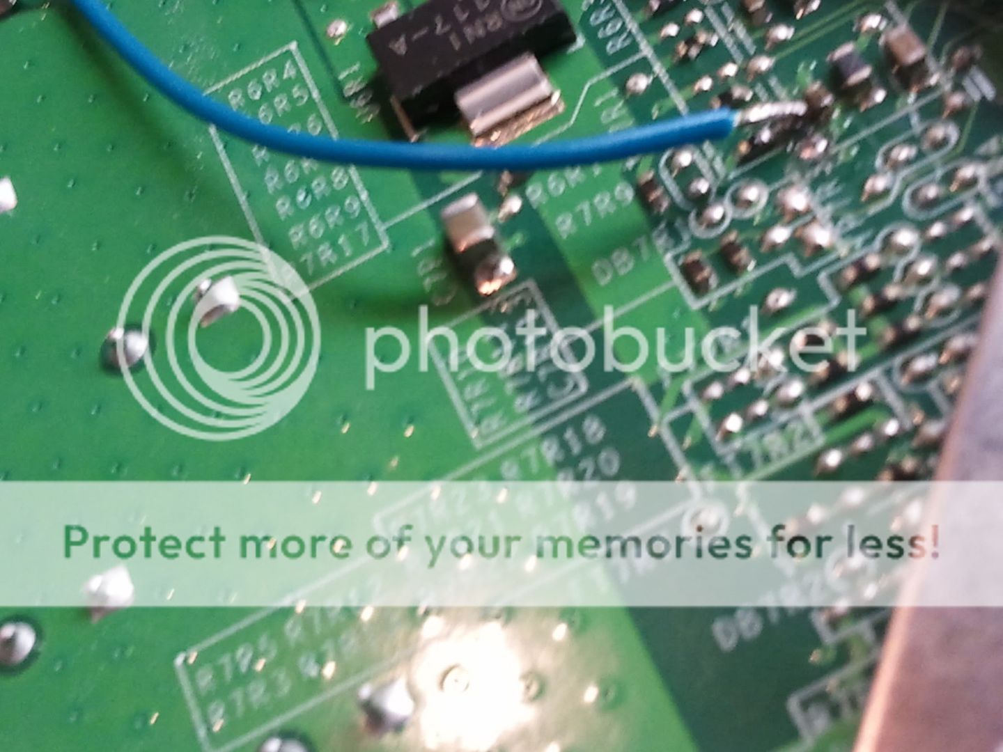

Coolrunner currently not pulsing no matter what I do.
This explains my issue: http://www.xboxhacker.org/index.php?topic=17541.0
But currently no solution. I'll try to see if I can get pictures of the PLL_BYPASS point.
My camera phone sucks, but here's the best one I could get.

It took me FOREVER to figure this out, but I finally have. The problem was a bad CPU_PLL_BYPASS point, despite the solder pad still being there and everything looking hunky-dorey. I installed the coolrunner wire by wire, each time testing with a power on to see if that wire/point was causing the rapid reset.
My green wire/solder point was bad. Soldered to the resistor instead of the pad, glitches first try! Still it begs the question...what is wrong with that point? I mean, it's not lifted or anything. Soldering to it caused rapid resets.
Well I guess if any other people have this problem, try an alternate CPU_PLL_BYPASS. Thanks for the ideas!
