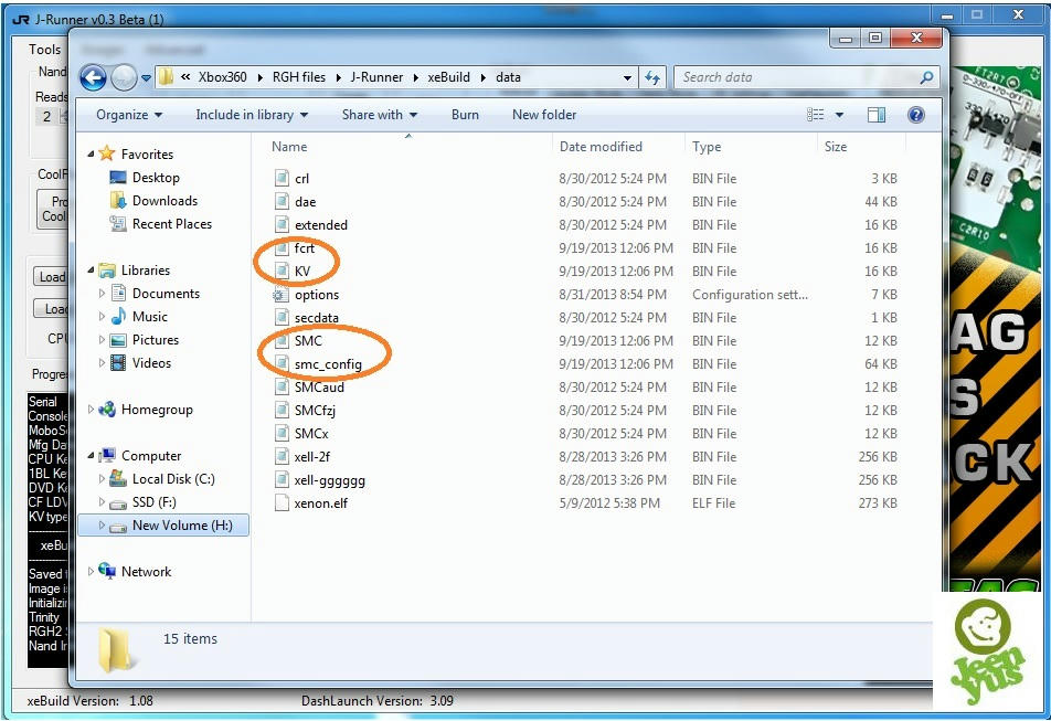

  • Open J-Runner app an click on "show working folder" button located at the bottom right
  • Open the folder name "data" located inside /J-Runner/xeBuild/ folders
  • Open your extracted nand files folder and copy and paste KV.bin, SMC.bin, smc_config.bin and fcrt.bin(if required) to data folder. It should look like this.

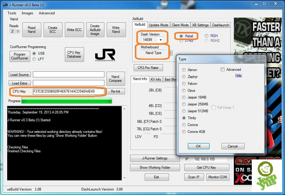

  • In J-Runner, copy and paste this cpu key F37C0CD50B928F4E67614ACD548A4E49 in the cpu key section.
  • Choose dashboard version according your hack type (for JTAG choose 7371 - for phat rgh1 choose 14699 - for R-JTAG choose 15574 - for phat RGH2 choose 14719 - for slim choose anything above 14719)
  • Select your motherboard nand type.
  • Select retail as your image type.
  • It should look like this.

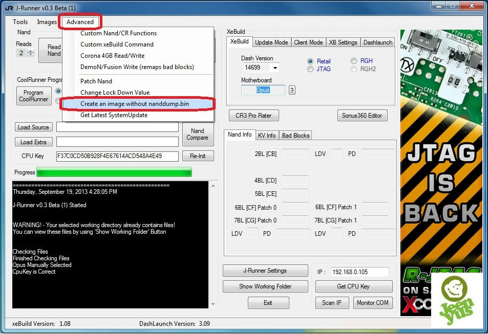

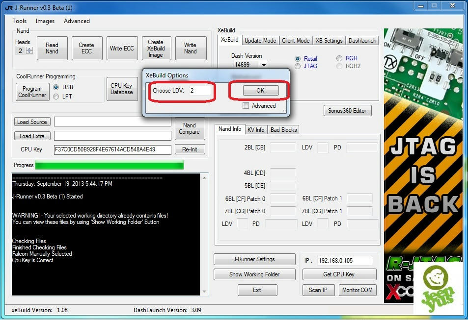

  • In J-Runner under the Advanced tab click on Create an image without nanddump.bin
  • Then you will be ask to enter LDV just enter any number between 1 and 80 and click ok.
  • At this point the dummy image should be successfully created and automatically loaded in the "Load Source" section.

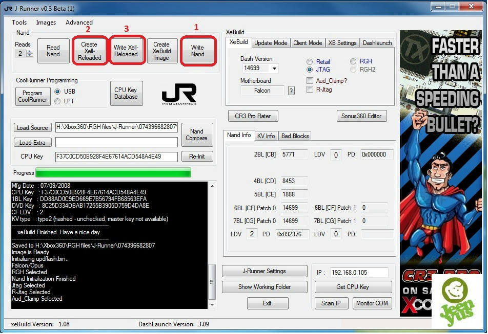

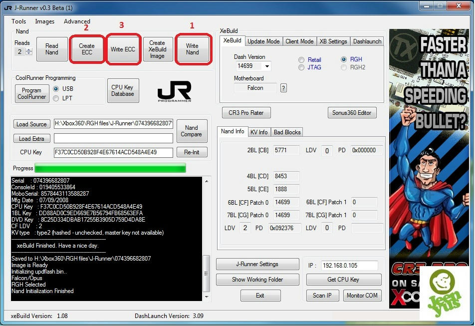

  • Now with your nand programmer properly connected to both you pc and motherboard click on "Write Nand".
  • Wait until J-Runner is finish writing the nand and select your "hack type" then click on "Create ECC" for rgh machine or "Create Xell-Reloaded" for JTAG/R-JTAG machine.
  • Now click on "Write ECC" or "Write Xell-Reloaded" depending on your hack type.

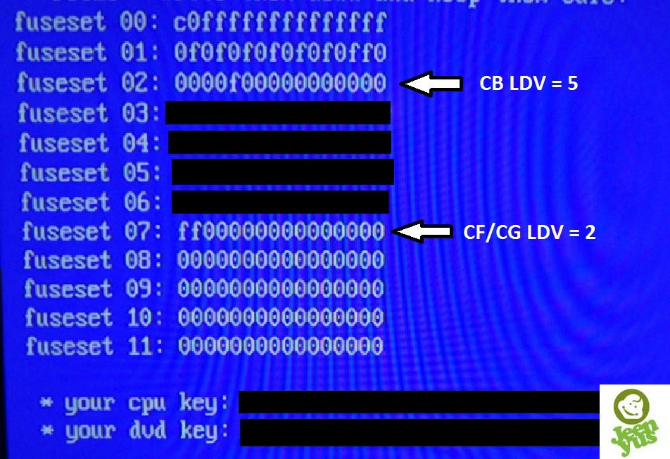

  • You are now ready to boot xell and recover your cpu key.
  • Disconnect the nand wires from the nand programmer and Power on your console and wait for xell to boot.
  • Once xell has booted, write down your cpu key, fuseset 02 and fuseset 07, 08, 09, 10 and 11
