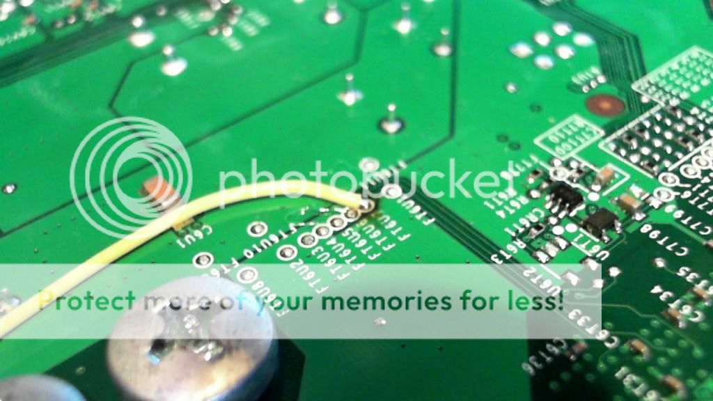

hello i have jtaged and rghed many consoles but having problems with rgh xenon any help would great.
ok heres the problem i cant get the debug light to flash at all only the red power light is on,
things that i have did so far are
flashed the xenon .jed file to the coolrunner vb.
have changed the wires 4 times
tried it on 3 differnt xenon boards
made sure the coolrunner was orig not a fake
changed caps to differnt sizes
i then flashed a zepher .jed to the coolrunner and installed it to a rgh zepher console to test if the coolrunner has bad or not and the debug lights works and the console booted hacked image fine.
so that means the coolrunner board is working fine.
for some reason i cant get the debug light to come on when its installed in a xenon console. i did every thing per the xenon instruction still no debug light.
does any one have any advice

Correct me if I'm wrong but I think your stb_clk point is soldered to the wrong pad. I have taken a close look at the pics provided by TeamX and it appears to be the pad that is towards the resistor and not away from it like you have yours.
I haven't attempted to glitch one of the Xenon's I've got here yet so maybe I've got it wrong.
Reactions: 2quick4u
2quick4u
Mar 10, 2012
o thanks every one i did not see that. i have changed to the correct pad and now my debug light is working thanks again every one
