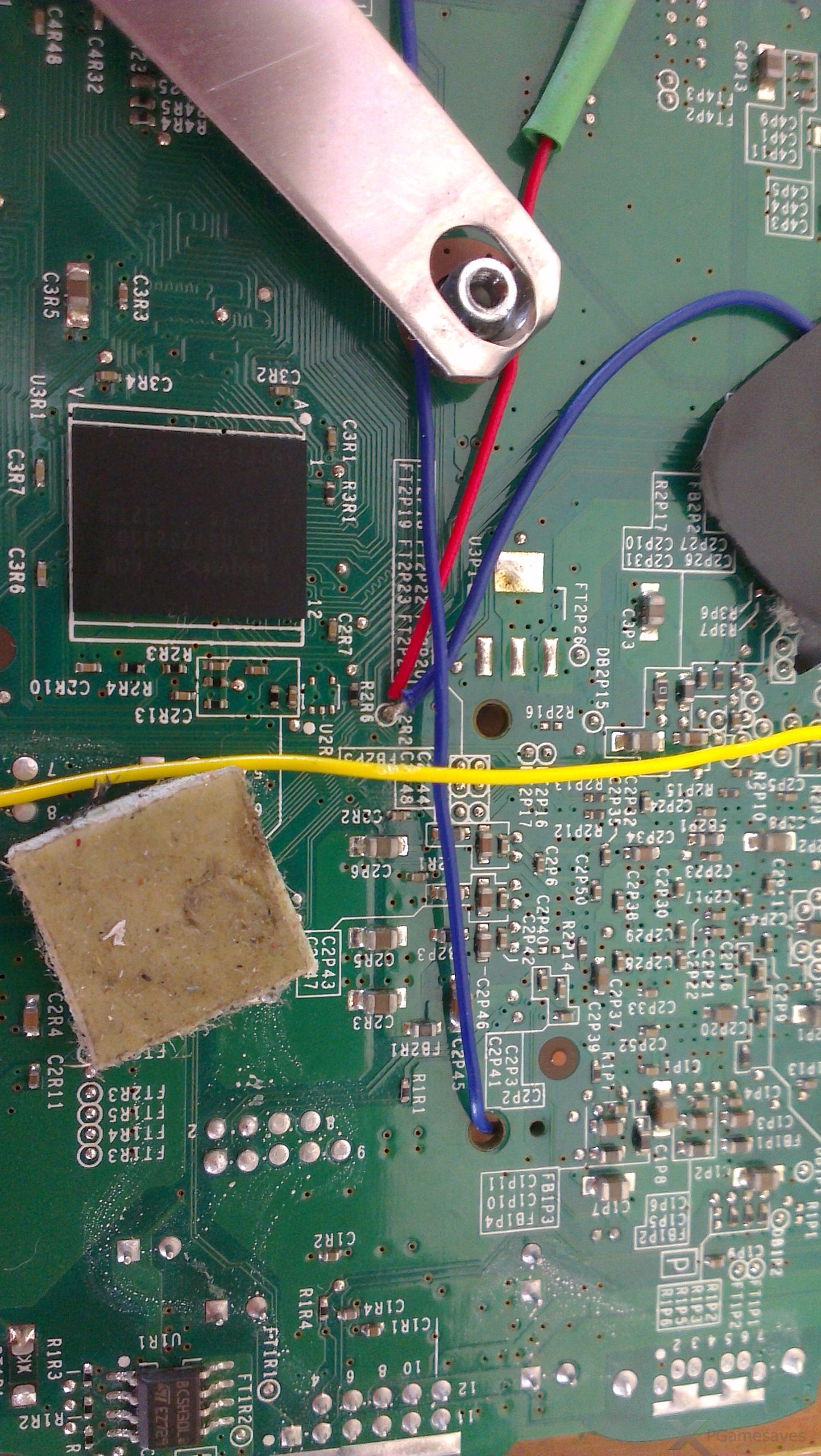

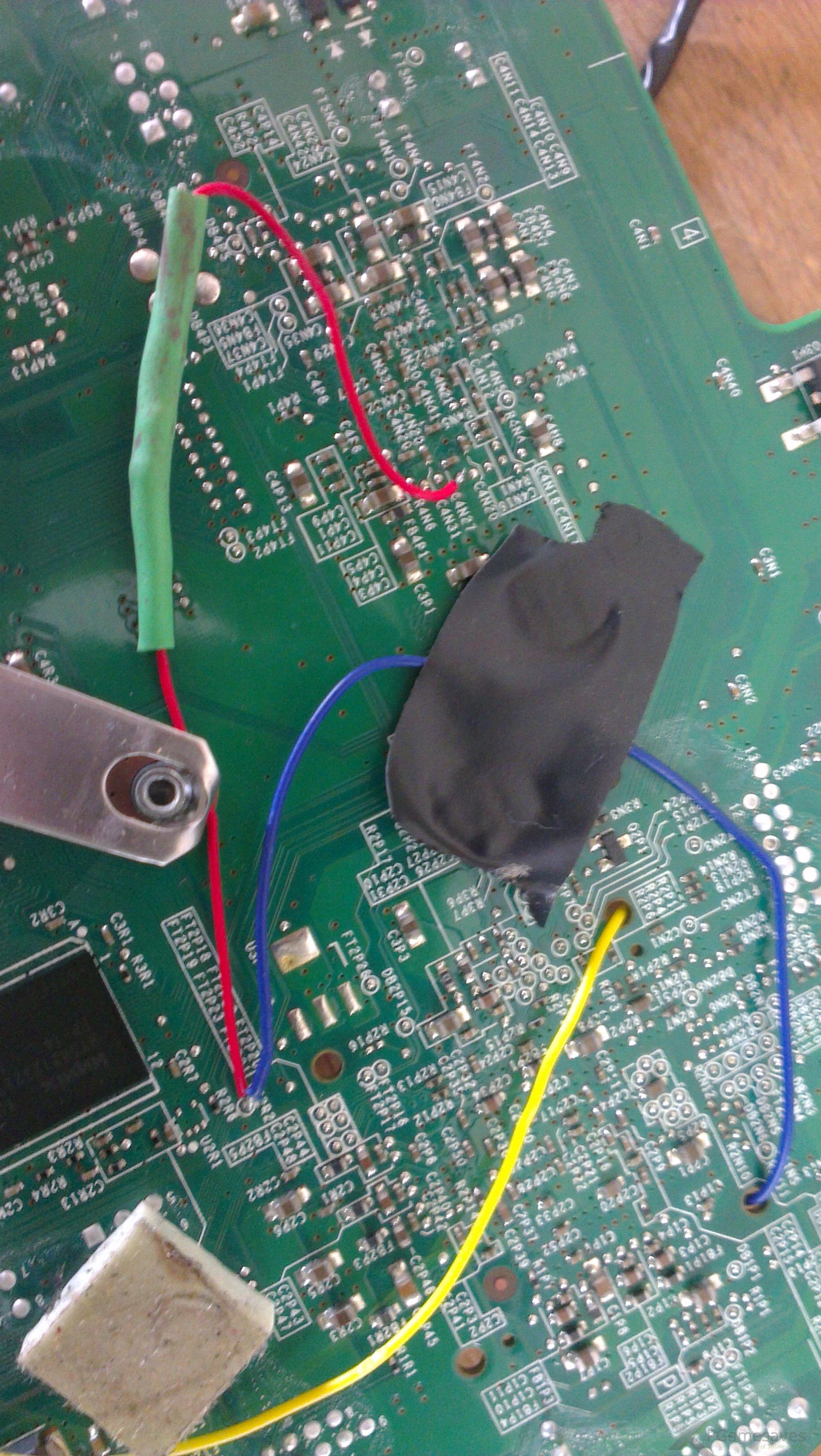

Right here a falcon that i originally started on monday
thought yeah got my coolrunner got a few rgh able box's on 14179 dash
started it everything was going well dumped the nand twice made the ecc file flashed that over and thats when the trouble started
would not glitch for the life of me hour after hour went by still no glitching tried this and that then bam booted xell thought sweet got the cpu key and made the hacked image then flashed that over
the box was not glitching minute after minute went by then it booted 4 min + everytime
so then it was a mission to reduce these boot timing cause they where all coming out at different times all long
after working on it till 2 in the morning bare in mind i started at 1 pm
then i break a pad on the xbox arrrrrrrrrrrrrrrrrrrrrrrrr and then a pad on the coolrunner lift off with all the messing around with it.
so i put it down and opened another box a jasper
got that done boot timing round the 20 sec mark so i boxed that up for rocky instead
this being the 3rd day now i turn my attention to this falcon again
right i goto fix 2 things before i can start messing again
1 being the coolrunner D pad (lifted due to the sh*t low loss cable to thick and not enough movement in it)
found a alternative solder point: (|Blue Wire)
then i had to repair the lifted pad on my xbox
heres the alternative fix i found on the here using a 330om cap and then a wire joined going to b on the coolrunner
once all that was done i turned it on and BAM 20 - 30 sec bot times HAPPY DAYS
