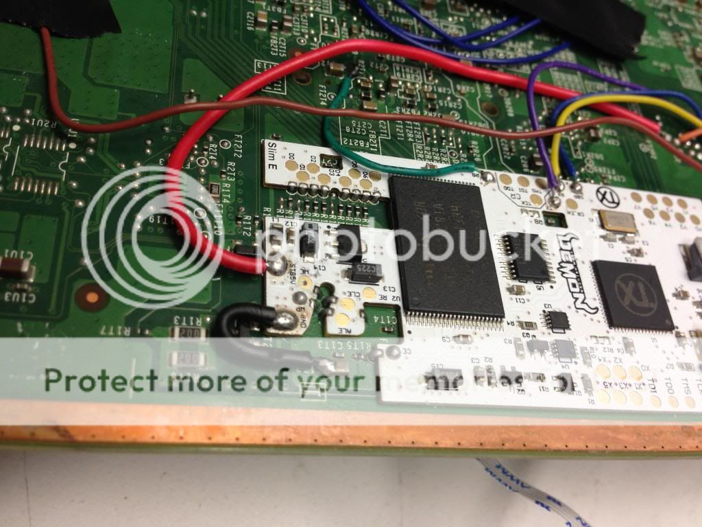

I could not get the console to turn on after installing demon just made the ping sound.
checked all my points actually removed and reinstalled demon 3 times
i finally gave up and removed the demon on this one.
but now with stock console noting on it i get RROD 0032 it sometimes will start to boot show the logo half way thru trows the RROD.
i did not touch the nand as i could not get demon to read.
also as soon as i plug it in it comes on and starts to boot.
what to do next?

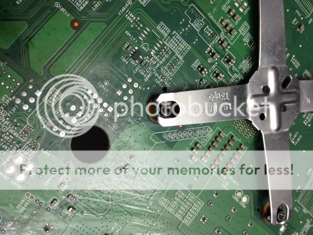

FIXED wow was a tiny resistor under Xclamp that was damaged.
weird cause i never removed xclamp must have been previous owner as i got it used and it was opened before.
like image bellow not actual picture

Oh my word, been searching for a fix to my 0032 error for days now and stumbled upon this, checked my board and BOOOM, exact same reason, exact same resistor, trick is, I've never removed the X-Clamp before checking. THANKS MAN!!!!
