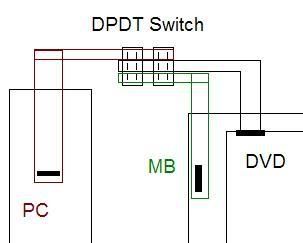

I wanna rig my system up so I don't need to open it up like many others have done. I cannot find a switch that has 3 rows of 4 poles, so i figured why not use 2 dpdt switches? shouldn't be a problem theoretically.
It looks like it should work right and if I wanna use the 360, both switches go up, if I wanna use the pc, both go down. Only thing i don't know is the ground. I wanna ground this but nothing here shows the option of doing so.
Should the connections already get grounded from the pc or 360 motherboard? Or do I need to attach something somewhere to create the ground from inbetween the connections?
