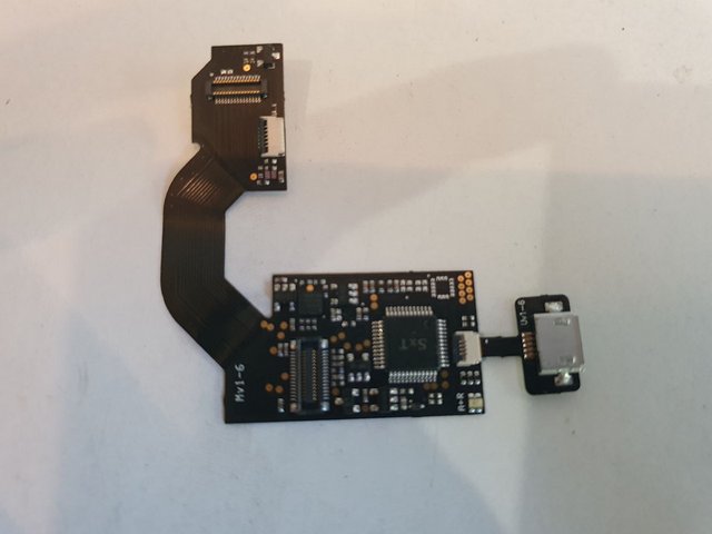

1. remove the SX Core / Lite from the Switch motherboard (don't desolder, only remove the ribbon cable)
2. remove the nand flash
3.connect the usb extension
4. connect with personal computer / laptop with windows. Unfortunately for now its the only supported operation system.

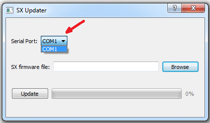

Here you need to figure it out to what serial port is the device connected. The easiest way is with SX Updater :
1. start the program without connecting the device. Check the available ports.
2. close the program
3. connect SX Core / Lite
4. Check again the available ports - you should have one new and this is the one you need.
Now to flash :
1. Be sure the device is connected and the right port selected.
2. in "Browse"choose the file for the update, something like sxcore_fw_v1.3
3. Hit UPDATE.

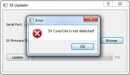

And here is the tricky part. Some people get an error :
Run the program as administrator. Try again and again, change the USB and in one point it will go.If you still get the error - try different pc and windows.
I had success on USB 3 and windows 7. I tried for 20 minutes before it happen. Some people have success with Windows 10 and USB 2.
