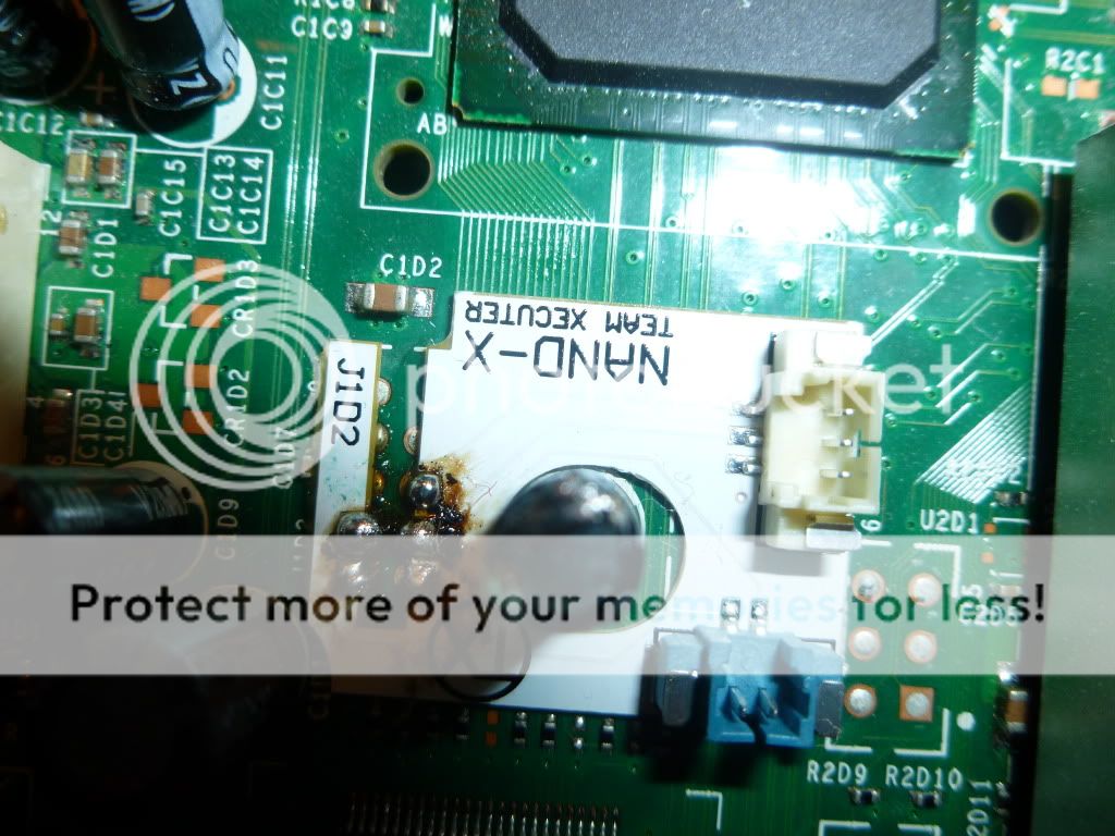

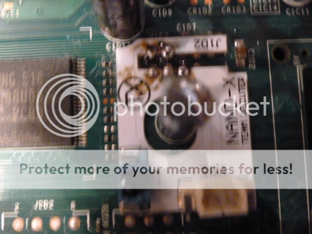

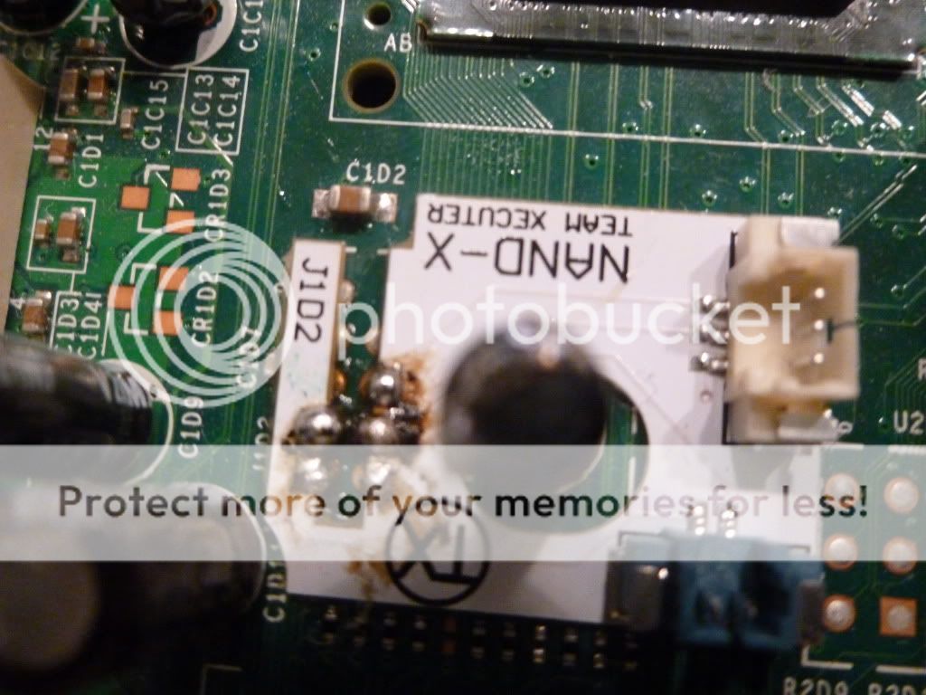

Hey guys I was hoping you could help me. I was installing my RGH QSB's and I messed up a little on the J1D2 pad. No pads came off but I just cant get the solder to make a good connection to both the qsb and pad. Here are some pictures:
Can anyone instruct me on how to fix this? I get a "Can not continue" error in nand pro and im sure my soldering is at fault.

You most def have bridges there. you should first try and clean it up some. Get some of that burnt sh*t off and check your traces. Id say to use desoldering braid and desolder you J1D2. Start over there!
Tip: Put flux on both the qsb pad and the xbox pad. Touch your 15W soldering iron to both the mobo pad and the qsb pad at the same time and then apply your fresh solder. You should be touching for no more that a few seconds.
And stay away from that Cap there before you burn right threw it!

Thanks everyone! Ill get some braid and start over. Idk why this one was giving me so much trouble while the other one did not.
I have a 30W soldering iron that I use as per recommendations from other users.
Oh and @Frazzeld , I cant right now but I clean, tin, and get rid of excess solder after every application of solder.
