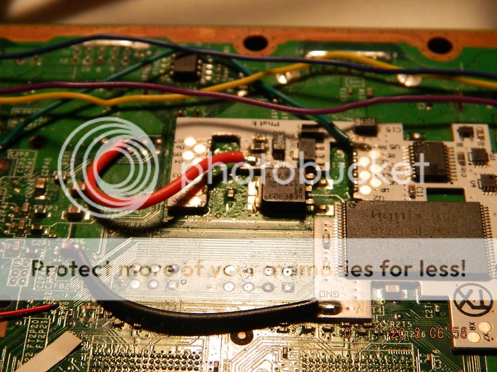

During an RGH writing the nand back failed, console won't boot at all now, I am getting stand by power, tried shorting the nand with no aval.
Anyhow is it possible to take a Demon and Coolrunner, write the NAND to the demon and just boot console from Demon?
Yes I have a valid NAND dump of the original. Console is a falcon, was having issues with glitches as it would not glitch with HD or DVD installed, so was going to erase NAND and write back, which failed on the write back and got the no flash controller detected error. It's all I get now.

try another erase of the nand,you will have to time it just right.put power plug in console,but not enough to give it standby jus yet,then type erase cmnd in nandpro,and as sooooon as u hit enter,plug power in,if successfull ull see it erase,this should solve the problem.most likley your smc was corrupted on bad write and thats y u get no flash config.

You can also just write the stock nand, using the demon to interface it.
Tried multiple times, seems I can't get the timing on that right. Tried all night last night.
That's what I was wanting to know, so basically I can do a wire install on the Demon, use it to write the NAND back. Remove Demon and all should be fine once again?

Still not booting. Just the demon is installed trying to boot stock nand off demon. Seems I cannot interface with 360 nand at all to write orig nand back as well. I must be missing something somewhere.

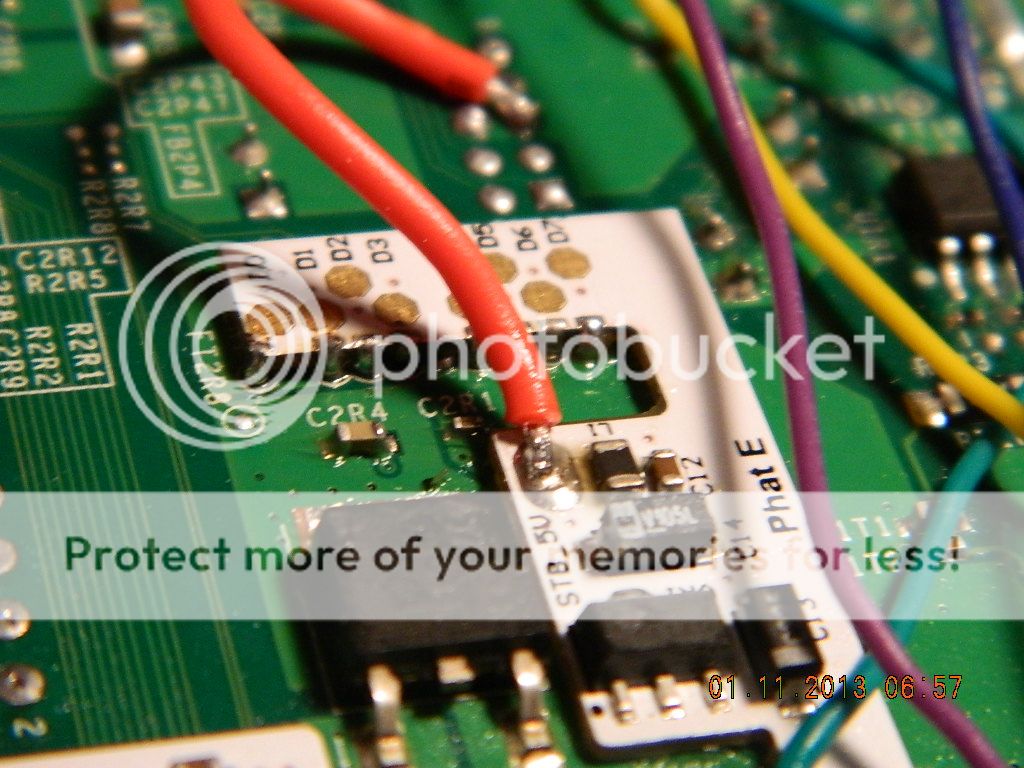

Why is your 5v STBY at 3.3v ?
Oggy
Mar 1, 2010
3,346
Apologies, I based it on another header.
What exactly do you mean?
I mean, whenever I've had an issue with either SPI or NAND interfaces, I get an error. I've never had a time when there was nothing at all.
Just surprising, that's all since all apps have an error function to output for troubleshooting.
You sure you're actually clicking the buttons?

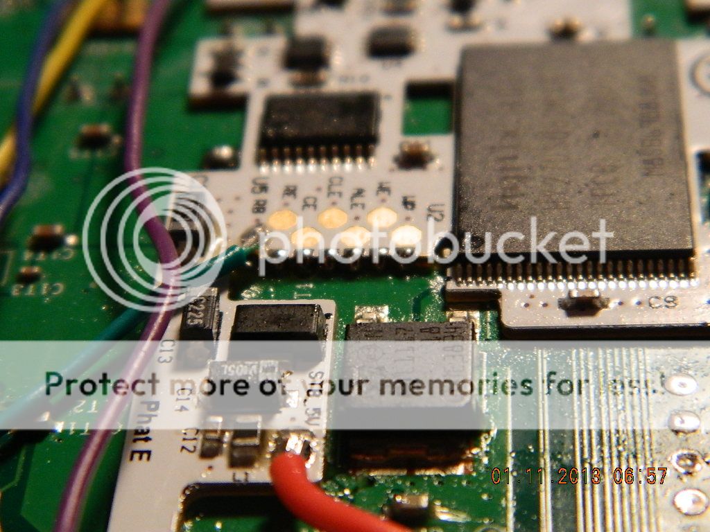

Whenever I couldnt get an ID on the stock nand, I touched up my soldering and it worked after....

You then have the cheek to post what you did. So seriously, do you want help or are you just posting on here for the fun of it? You've not posted any results on continuity testing, both between the DemoN to the 360 NAND, or neighboring points to ensure there are no shorts.
If you don't have the common sense to at least see that an error code is useful, you're wasting your time. It appears you have a fault with the console since you couldn't get the SPI to work (again, no error messages or readouts from the SPI points so more Gipsy Rose Lee guesswork). I would therefore look to someone to repair it before going any further or wasting anyone else's time.

Only 5 post were related to the actual demon install ;) and my first post stated the SPI read out error "no controller found"
Sorry not everyone comes in here and post every little thing they did to get to where they are, we all can't sit around all day in our mothers basements waiting on someone to post just to ridicule them with non sense on how they didn't post a picture of soldering, or what the readout says from Jrunner. Wouldn't it have been easier to just move on and leave the topic be? We buy Xecuter products, install them and run into an occasional error. So we ask for help and either get called a dumbass or get banned for being a smartass back.
Back on topic, I'll touch up soldering and see if anything changes. Thanks to those that helped and thanks Martin for the laugh. ;)
