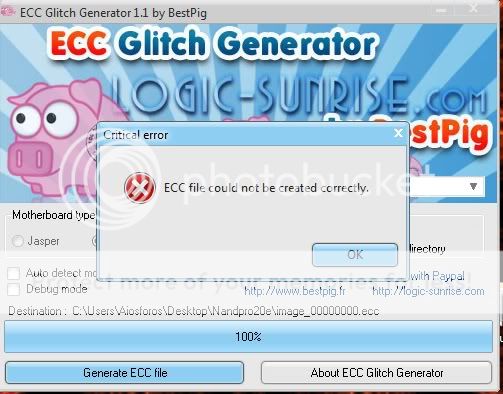

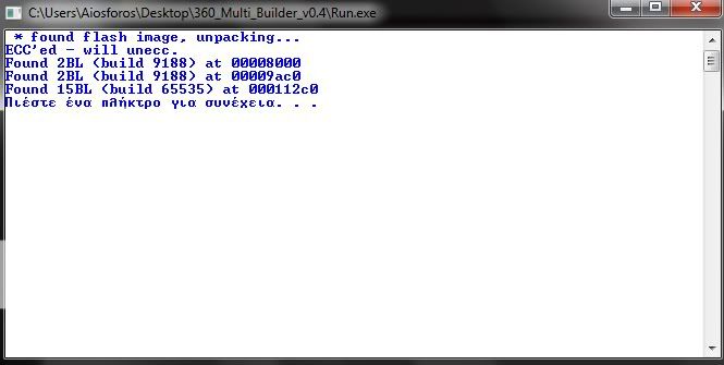

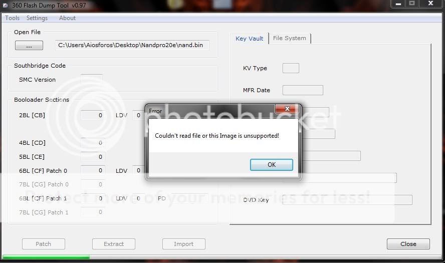

1 360 flash tool dont recognize the nand dump
and 2nd i cant create ecc file neither manual nor with multibuilder or ECCGlitchGenerator11

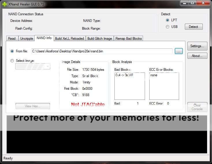

and one weird thing is that the xnand healer can recognize the nand, but also cant generate ecc file

im trying atm that solution with an ecc generated from other slim dump, but the problem here is that i cant generate ecc file from the nand or even open the nand on 360 tool
EDIT: tried using ecc from other console and following these steps
http://www.team-xecuter.com/forums/showthread.php?t=76014
it restarts every 6 seconds but not booting into xell
Right - try this:
nandpro nand.bin: -r16 bb1.bin 3FF 1
nandpro nand.bin: -w16 bb1.bin 4
To elaborate, NAND tools might SEE a block has been remapped but won't do anything about it.
The above SHOULD allow you to open it ok.

omg stupid nand image, costed me 5 hours today for a stupid remap,
thnx martin the remap worked to open the image

ok, so nanddump.bin is your ORIGINAL UNTOUCHED NAND. Yes?
CF LDV : 2
Boot to XeLL and make sure the number of FF's on lines 7 and 8 match this number.

actualli quite nothing, i regenerated the image from multibuilder and did
nandpro usb: -w16 nandflash.bin
and thats it
obviously it had the block remapped correctly ;)
