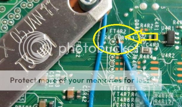

This looks a little sketchy, I assume you've checked them over?
Also, this is probably not an issue, but the way you routed your CPU_RST is a little odd in that the bare wire is resting (or bridged) to the bare pad beneath it...but like I said, doubt it's the issue.

To all that helped I appreciate it.. after pulling everything back off of this motherboard, I started replacing each individual part and found the problem in the cpu-rst wire. Replaced it and it boots xell no problem...
Now on to the next project!!

Congrats man! Guess it was bridging huh?
