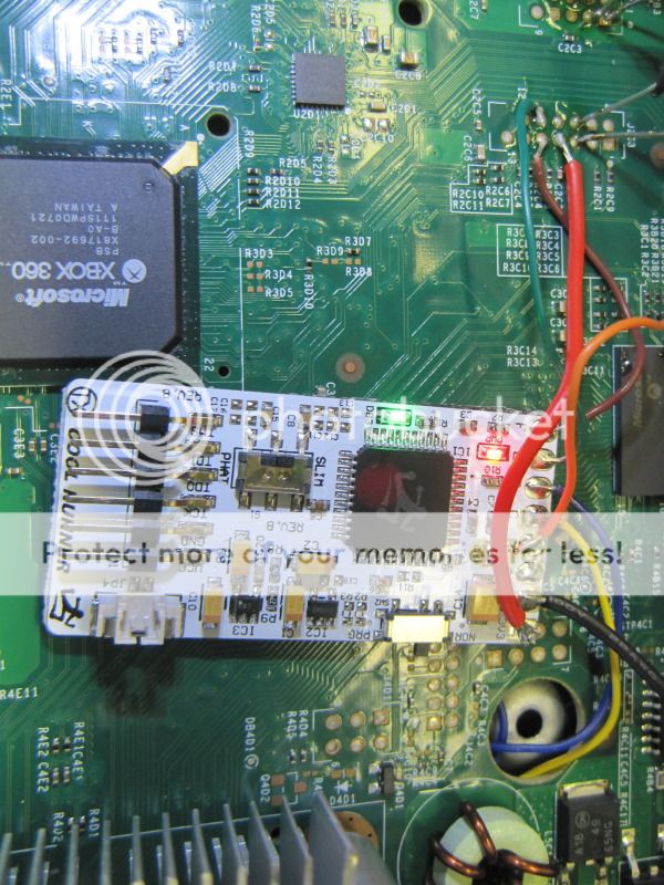

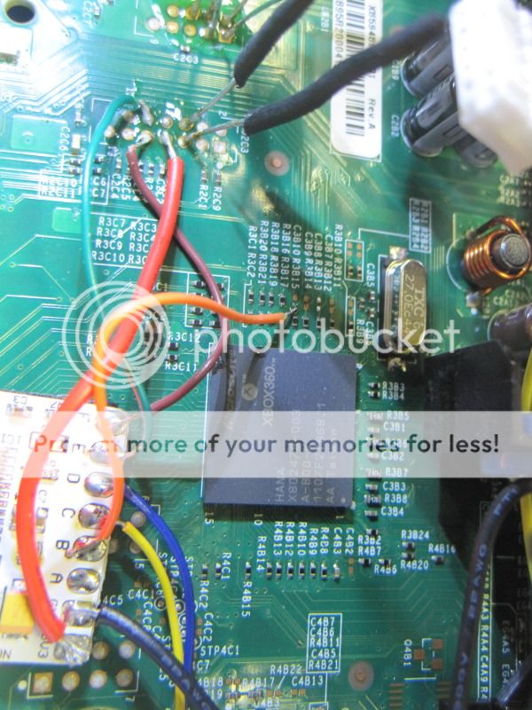

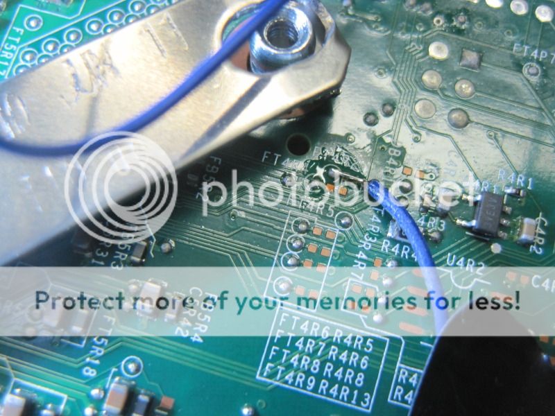

Hey guys, I have a Trinity that will not boot to Xell. I have never had a problem booting a slim to Xell before. I do have bad blocks at 3 and 37, but both nands read the same, so when I created the .ecc image J-Runner said it was remapping them. I suspect that may be the culprit? Here's my output log. Coolrunner does flash green trying to glitch, but just wont catch.
