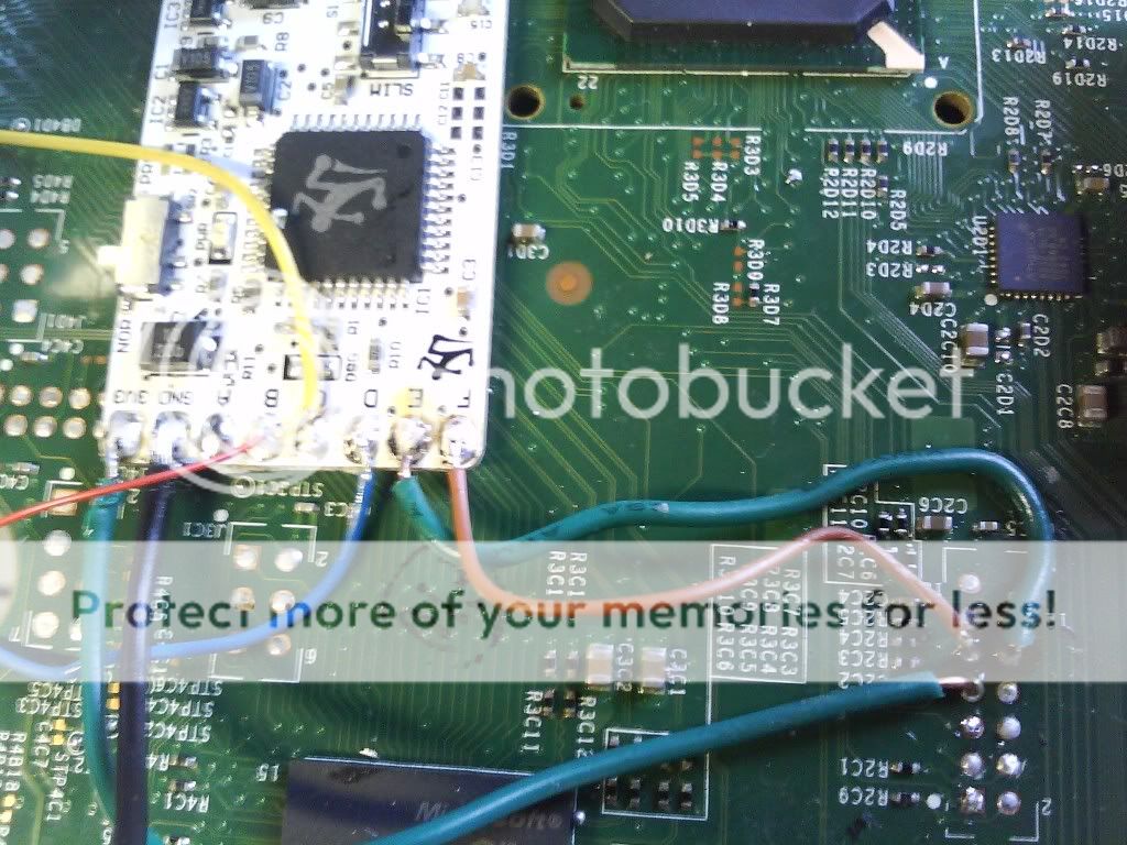

OK Ive done 3 slims so far but this one is a pain. Got a slim Man 3/11 - Dumped 3 times all match and all clean.

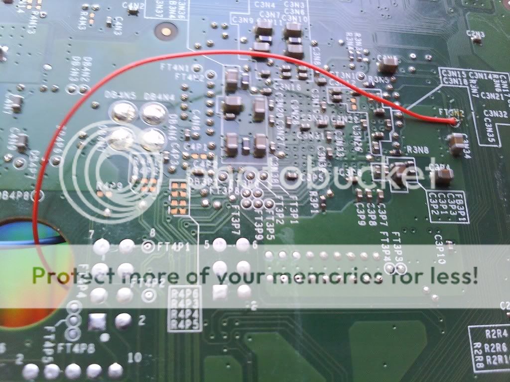

I've created the Ecc from both JTag tool and GGbuild and cant seem to get the glitcher to flash green. I've rewired everything ALOT. Doing so I managed to pull off the Orange wire pad and Yellow wire pad -. I wired in a jumper on the Orange line so that the console boots again (verified by rewritting the orig.bin) and moved the yellow to the CPU side under the heatsink. The Orange wire was moved to the bottom side to prevent any further damage.
Either way I still can't get this to glitch- What am I missing? And yes I've programmed the chip once before all the troubles and a few times since to be sure. I've even tried 2 other coolrunners just to be sure it wasnt a faulty board.

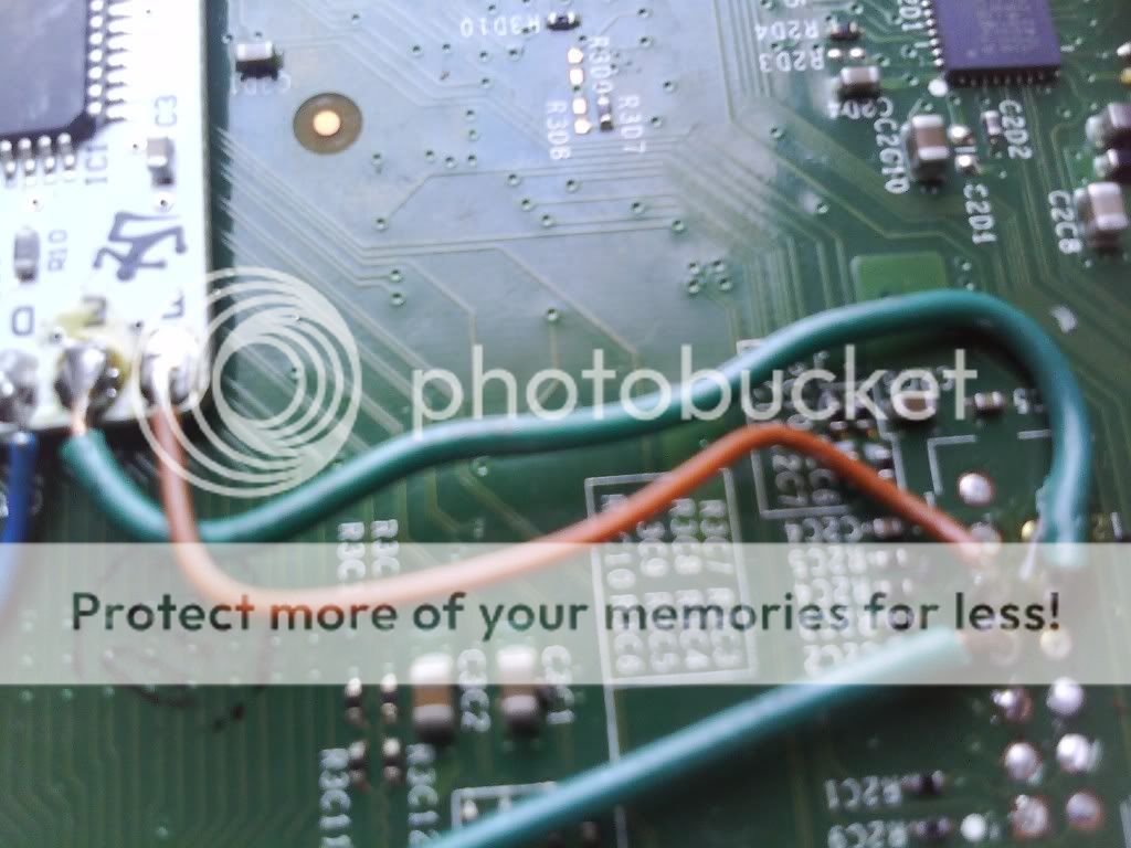

Oh and before someone asks the 3.3v line I replaced the braded wire with a solid copper wire (green) to ensure a better connection at the board.

Is there one wire more than another that causes the actual reset light? Or can an improper contact on any of them cause it not to flash.

The blue wire (CPU_RST) is the one that will usually stop it glitching on a slim. Moving it to different areas, coiling it up too much, wrong length, can stop it from glitching.
splatem
Aug 6, 2011
79
Sth Island, New Zealand
If blue isn't connected, it won't flash. I would try taking off the heatsink, and test for continuity from pad D on coolrunner to the copper pad further along the CPU_RST trace under the heatsink x-clamp on the bottom. I would also test for continuity with the CPU_RST point under the heatsink on the top of the board. If you have lifted the blue wire solder point, it might not be connected to it's trace on the top side of the board. There is an alt point thread created by thebomber which shows the points you can test at.

but bk to the problem what did you use to program the CR also how are you witing nandx ?usb?lpt
also do you have a green led on when you are trying to program the coolrunner?
