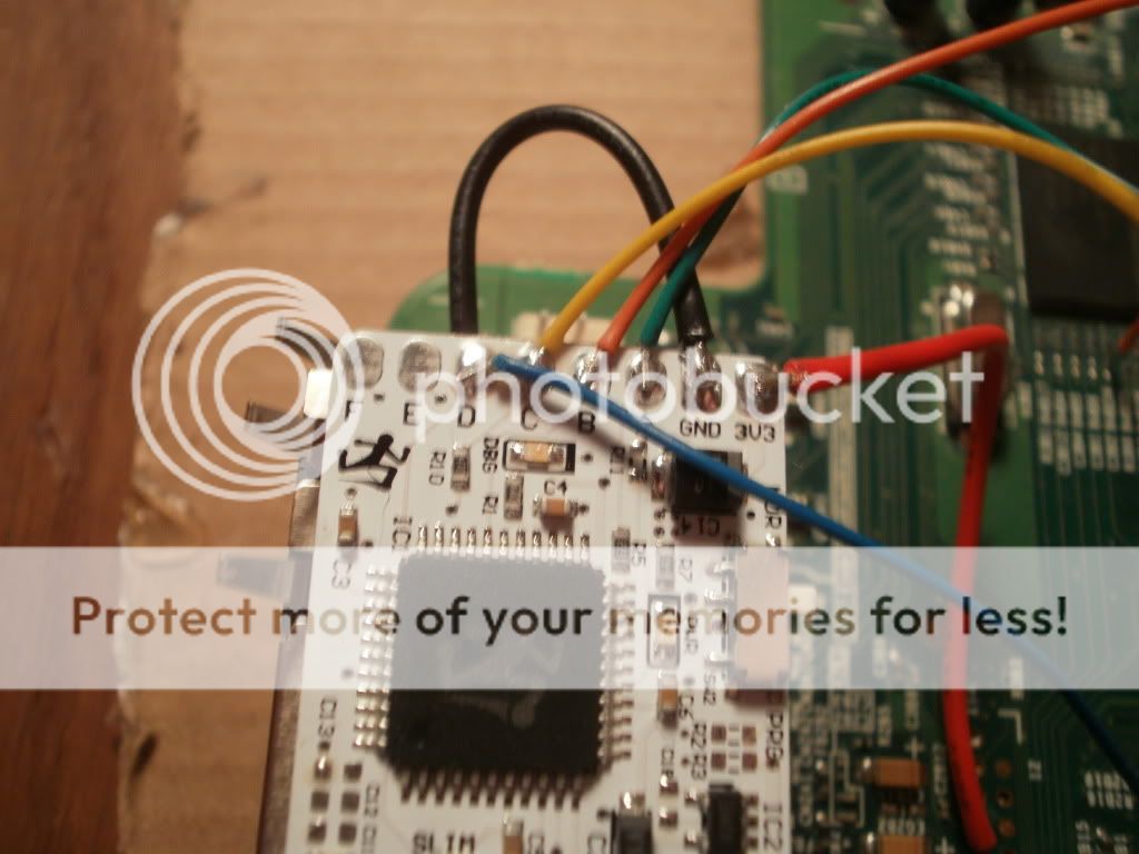

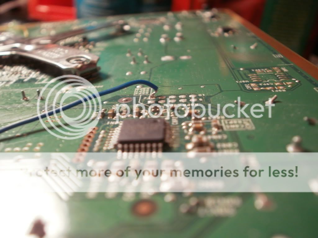

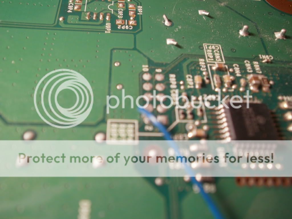

ok so i programed my coolrunner and i installed it.i created and wrote the ecc then tryed to boot. the coolrunner comes on as soon as i plug the power cable in,the install looks good to me but when i boot i dont get any picture

Post pics of your install. also how did you program your coolrunner?

MightyShots
Aug 31, 2011
305
Walsall, United Kingdom

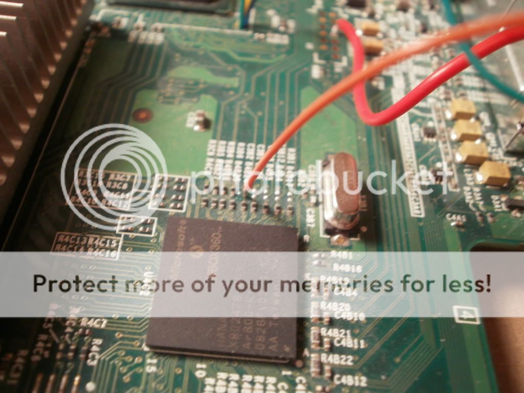

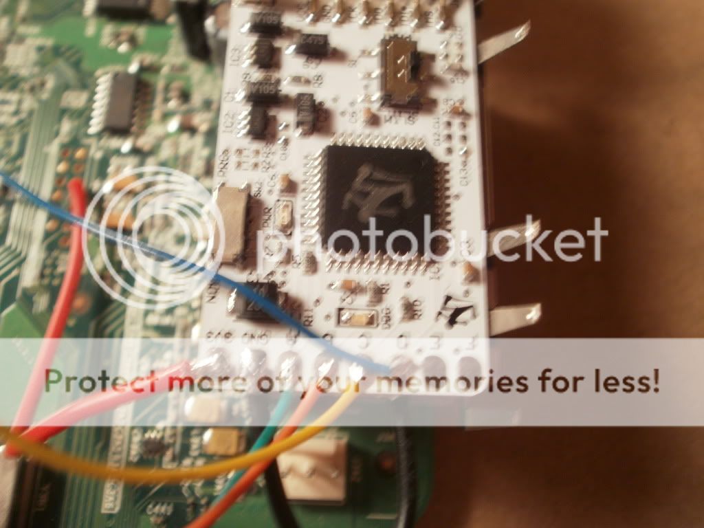

Martin and nastybrother24 want to see the joints from a aerial view, the pics you posted are being blocked by the cables mate
---------- Post added at 17:43 ---------- Previous post was at 17:38 ----------

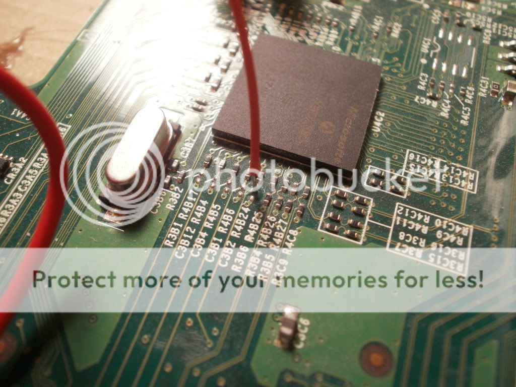

Martin might correct me here, but your PLL_BYPASS looks like its soldered to the wrong point??? Unless thats the alternate point, as the original looks shafted.
superben51
Jan 20, 2012
18
oh.. your right so would I attch a wire in the middle of the one going around the bored? also could i still use the first point or is it shot?
Feb 28, 2011
1,405
united kingdom
you can attach the wire any where you chose after you repair it. Either solder point you used during the repair or if you aren't to confident at soldering 2 wires to 1 point anywhere along that wire will be fine.
---------- Post added at 02:01 ---------- Previous post was at 01:59 ----------
looks like the green wire is on wrong point or not solder correct
You really should learn to read the whole thread before commenting.
rexdale
Jan 7, 2012
34
So the original point is toast ?
can't really tell.
But, i can tell u that if u want to use the alternate point, then the green wire u have is fine, just attach another wire going from the second point near the cpu to the point A on the coolrunner. So, you would have two wires soldered onto the A point on the coolrunner.
Or u can try soldering it directly onto the resistor, so u have two wires soldered onto the resistor
superben51
Jan 20, 2012
18
Hmm.... I would really like to use the original point because I don't really want to take off the clamps on the board so I'll try to resolder it when I get home
