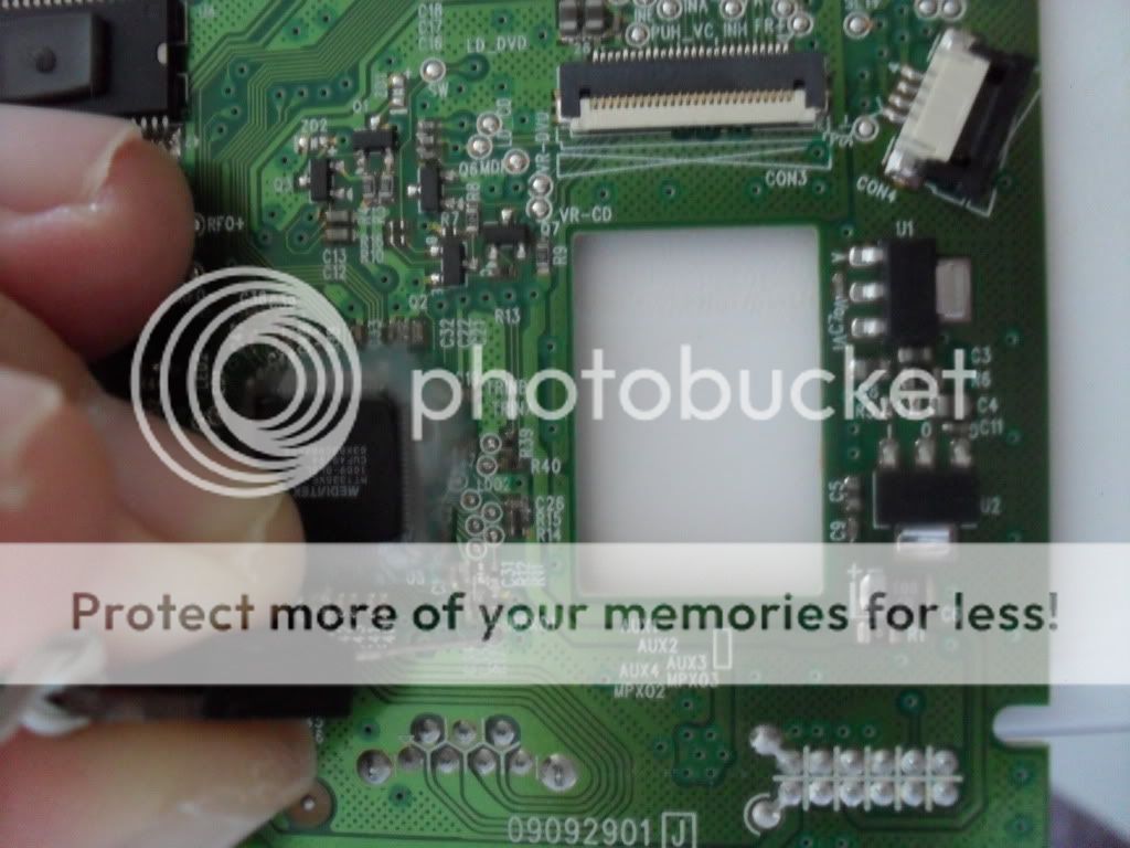

hello I can't get to vendor mode when I click the intro device. I already cut the trace. It is detected by jf 1.85 and Im using via 6421. I power cycled it many times but no joy. via only and phat checked. Status is 0x51. Its MXIC. How can I put it to vendor mode?
Try recovery mode, put the probe on MPX01.

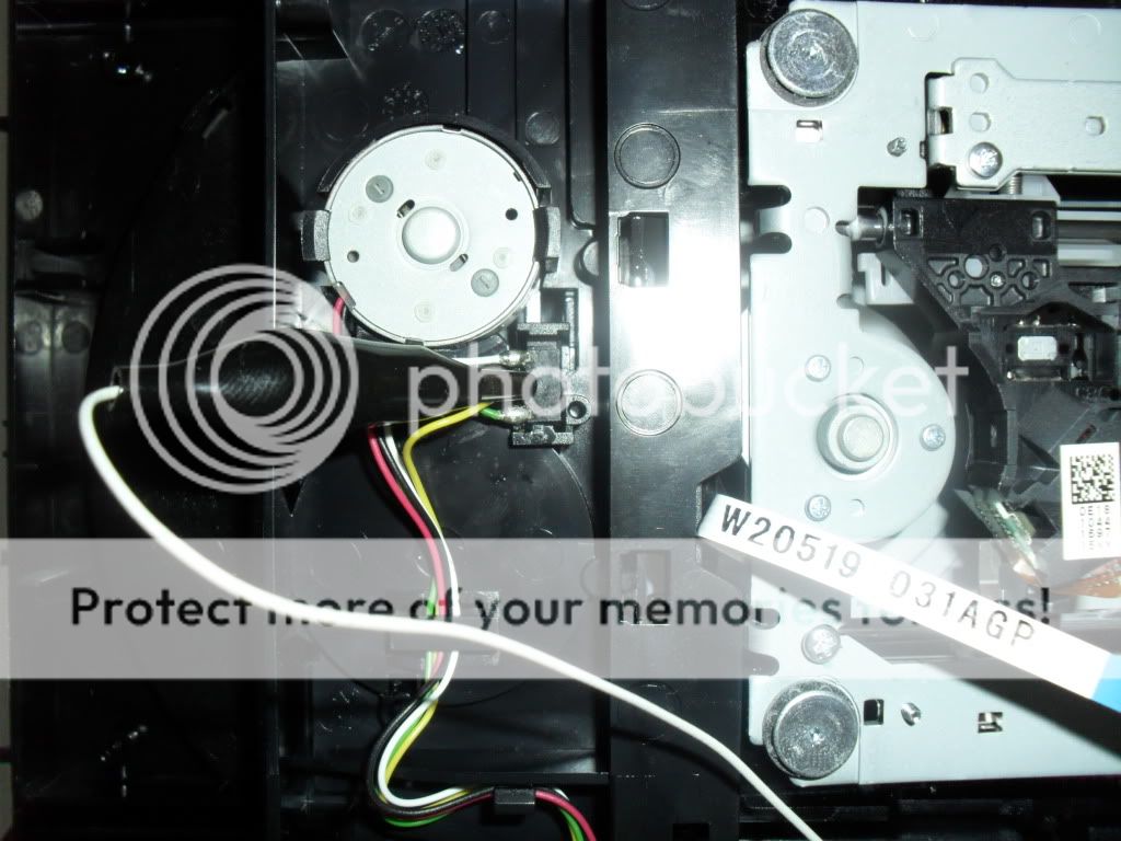

sometimes ;), the drive always comes at vendor mode with a probe connected to the yellow wire and MPX01 point.
Press [Intro device ID] then click on yes, Turn off the drive and put the probe on MPX01, connect the drive and remove the probe.
This works always and You can be use in cases of BAD flash.
