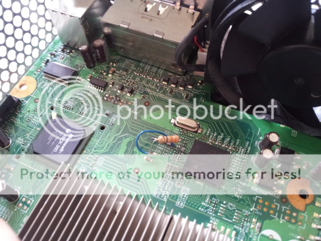

Looks ok, now test for continuity between the resistor end at the HANA chip side and the alternate STBY_CLK point underneath the board.
Jun 4, 2010
3,080
Ohms, im not close to a motherboard right now but there should be a complete circuit with 0 ohms.

it gives me a read of 30.1 ohm
---------- Post added at 16:56 ---------- Previous post was at 16:53 ----------
nop my bad 70.0
---------- Post added at 17:00 ---------- Previous post was at 16:56 ----------
this is crazy -0.2

I'm away from home now until Monday so I can't test a motherboard to read the resistance it should be and I can't remember of my head. It should be either 0 or 33ohms one of those two but most likely the 1st.
Note, you're not measuring from the point where the resistor begins? Just from where it is soldered onto the motherboard next to the HANA chip and the alternate point below.

right know i solder the resistor and a cable to the alternative point because the other one got rip. I measuring from were i soldered to the motherboard to the alternative point. (the cable im using to join the points now is really long)
