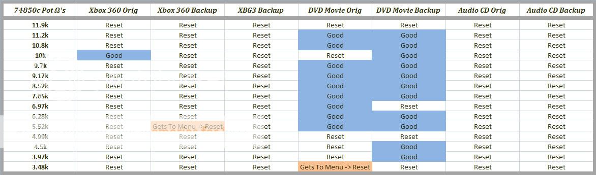

EDIT:
Just tried playing with tweaking the pot some more - some strange findings:
Also, here is a YouTube video I did which will hopefully explain it better. Many thanks!
[ame]http://youtu.be/GCvrZjeei8U[/ame]

EDIT:
